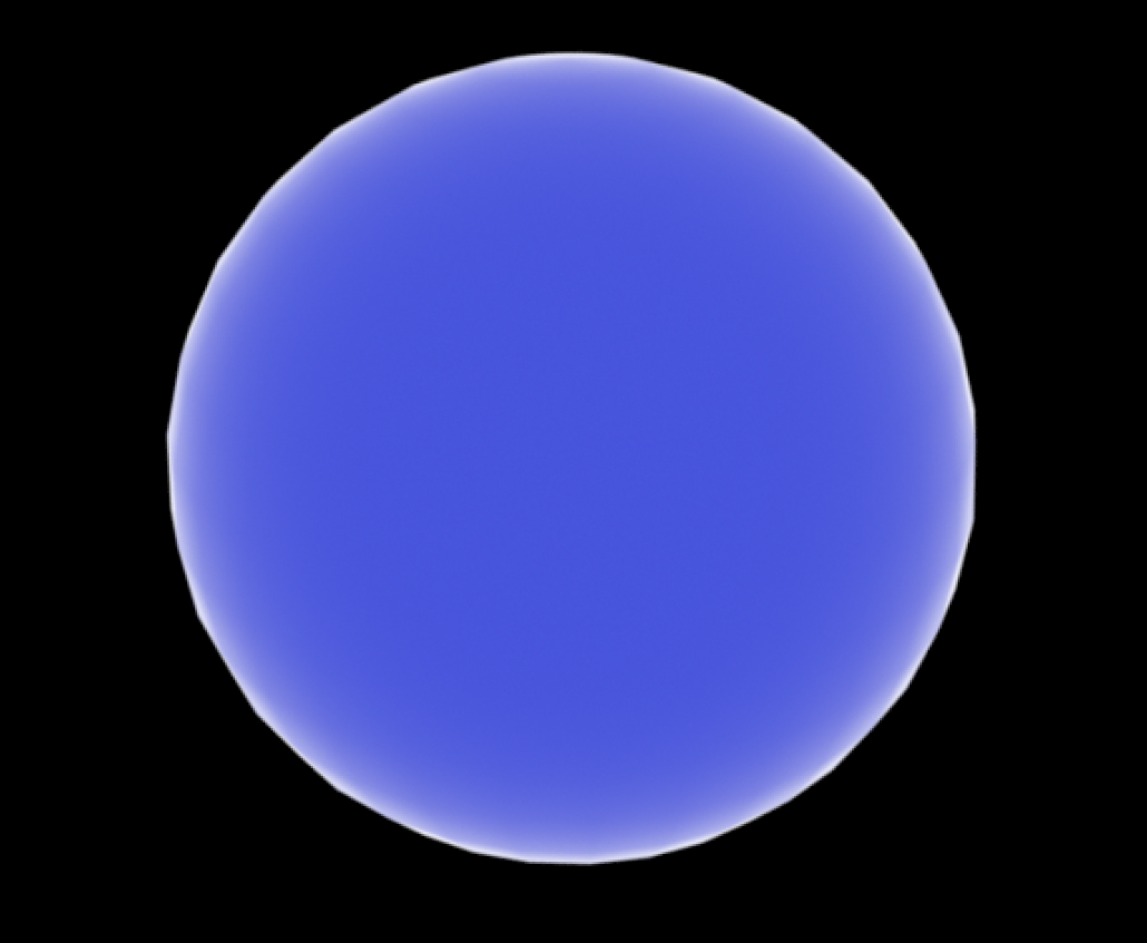

I'm sorry but I may not be understanding your comment correctly. I already have my color management set up as described in your blog. My issue is that saving an EXR through blenders (F12) Render -> Image -> Save As -> OpenEXR gives a different image than saving the EXR via Octane Viewport or Octane Output.
The Viewport, (F12) Render view and the Octane Viewport render all show the same image.
EXR Saved from (F12) Render -> Image -> Save As -> OpenEXR
EXR saved from Octane Viewport
My goal is to have an EXR saved from Blender's native render window be the same as an EXR saved from Octane's viewport window in Linear. Just to avoid any confusion, by Octane Viewport I mean the "Show Octane Viewport" found in render settings.
