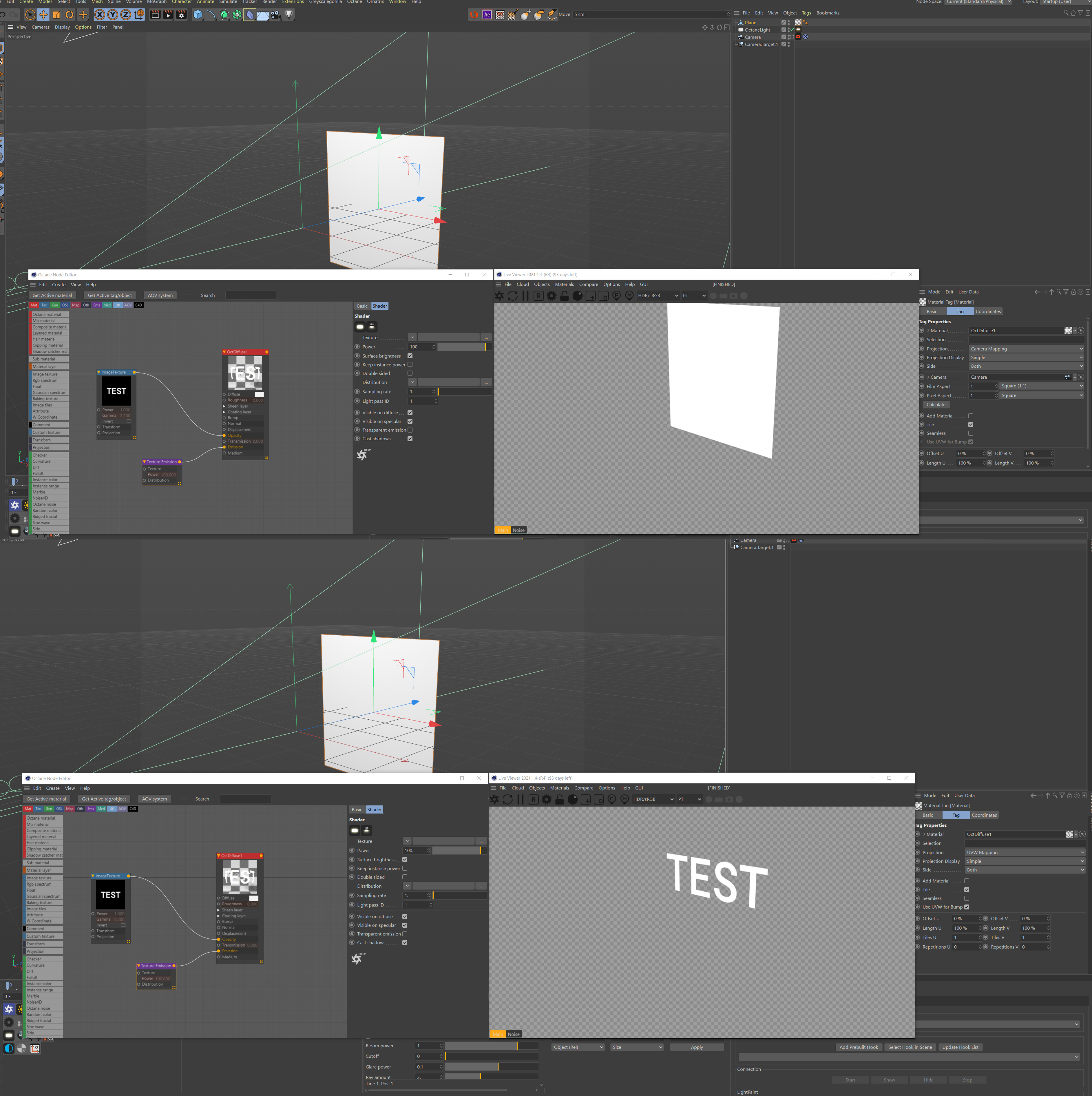

Here's simple example. There is no alpha with camera projection but when i hit Generate UVW from camera projection everything is okay. But im sure i've used camera projections in octane before.

Ok your problem is about opacity. There is a problem with that since I've added stacked material support for camera mapping. It's destroying the opacity connection for first material. Fixing it for next build.
