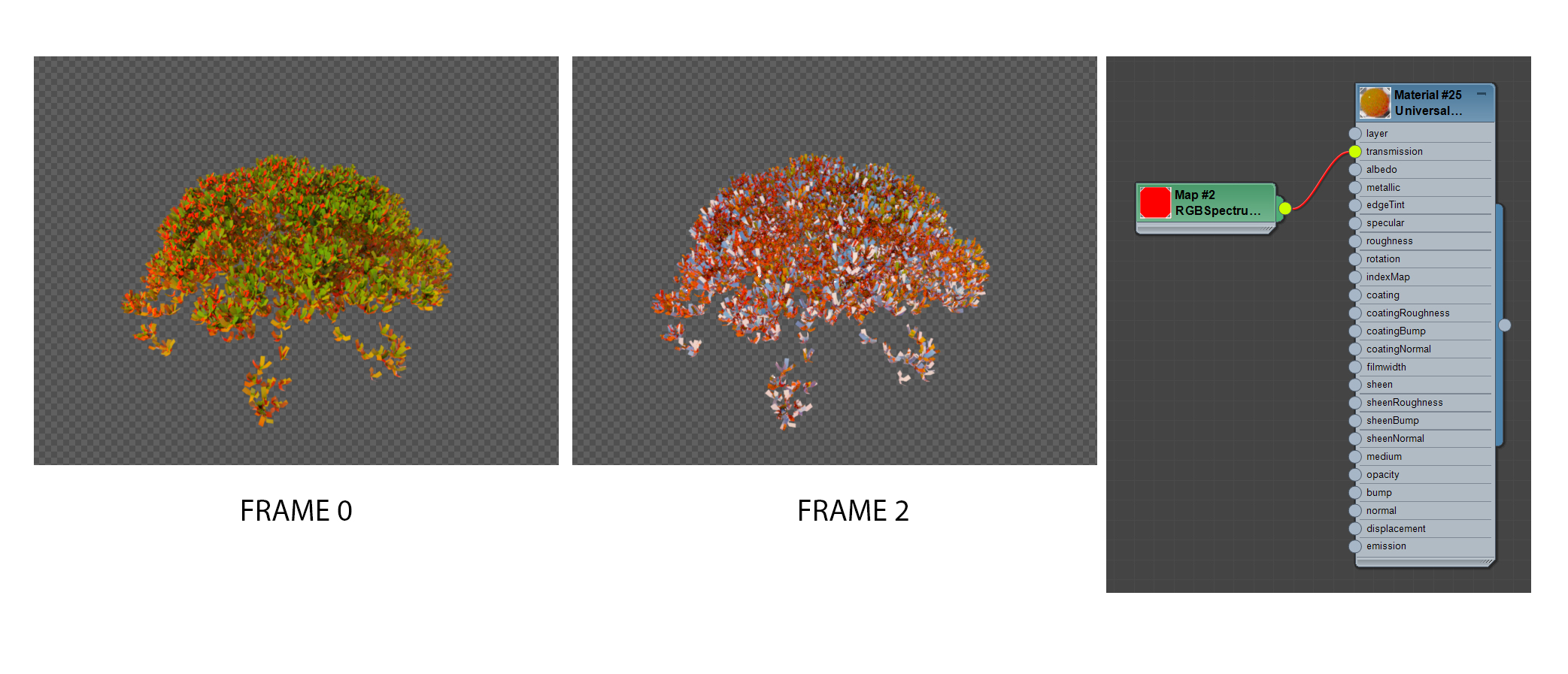

I have a problem with transmission in this universal material.
If I remove transmission there is no more flickering.
I can't find why... :-(

Hi HHbomb,
I sent your issue to developers. Something is going wrong with the that Max camera.
Regards
Paride

Hi, Pardide, this happens in perspective view too.

Hi HHbomb,
Thanks for reporting this issue.
It seems to be a problem with 2021.1.4 engine.
It should be fixed in 2021.1.5

Hi, NZ.
I need to have "nested dialectric" OFF. When ON this problem occure.

HHbomb wrote:Hi, NZ.
That's right. There was an issue with dielectric.
It has been fixed in 2021.1.5:
viewtopic.php?f=80&t=79807
