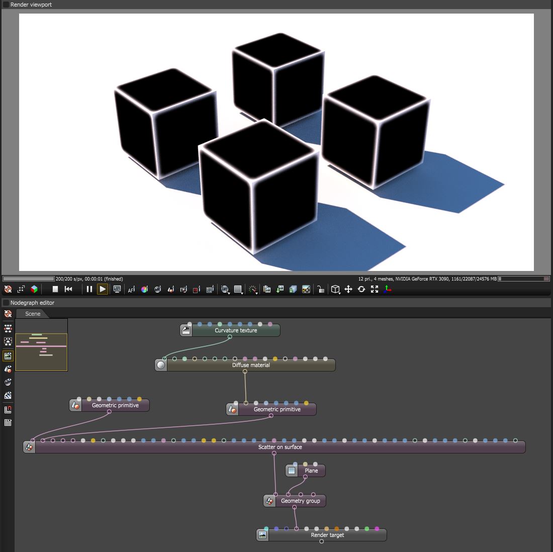

john_otoy
Posts: 255
Joined: Tue Aug 10, 2021 9:38 pm
That should work. Here is a test.
WoutTgh
Posts: 182
Joined: Sat Jul 27, 2019 8:39 pm
ooh okedoke ! maybe something in my setup.. or Houdini... thanks !
