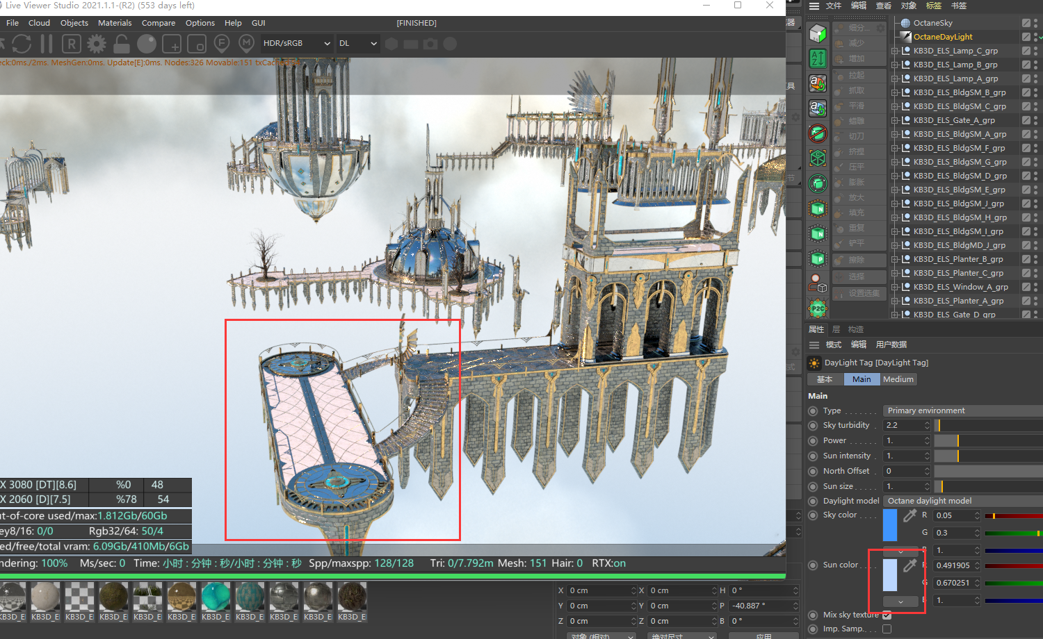

Cinema4D R23:Sunlight color, cannot be modified !!!!!!!!!!!!!!!!!!!!!!!!!!!!!!!

@Sunshine_wuyu
Please share some screenshots, everything is working as expected here with Sunlight color:
ciao,
Beppe

bepeg4d wrote:@NC17z
if I remember well, it should be 2020.1.5-R4.
@Sunshine_wuyu
The attachment FCB13BB1-78FB-460B-AB1E-B95C7D323F2E.jpeg is no longer available
ciao,
Beppe

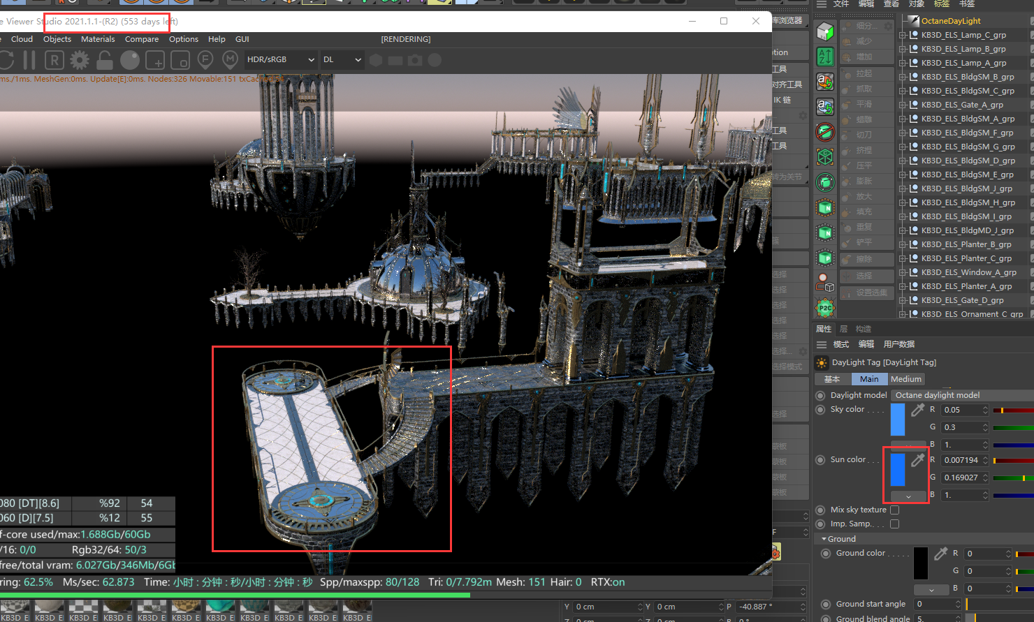

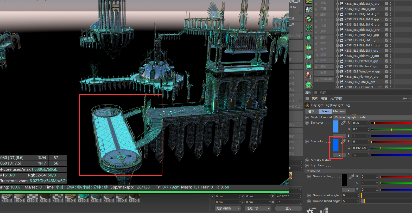

I have found the problem. The sun is seriously reddish. It never had this problem before. Now the sun is very red. No matter how you adjust it, it is seriously reddish. The white light cannot be adjusted. The real sun is not always reddish. I have already returned to 2020.1.5-R3 and will not upgrade for the time being
Posts: 10609
in 2021.1 there is a new White Light Spectrum menu in the Kernel panel, and by default is set to D65.
You need to switch to Legacy/Flat to have the same result as before:
ciao,
Beppe
