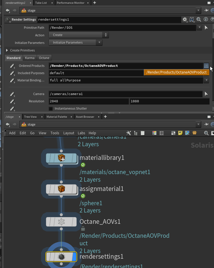

Right now, Octane AOV output group(compositing AOV workflow) and Output (like OctaneROP) node are WIP.
Octane AOV product need to be added in Render settings>Standard>Ordered Products
Please find the sample file and let us know how it goes!

BK wrote:Hi Creative_Sheep,
Thank you for the post.
We plan to start our documentation as soon we are Octane feature complete.
cheers
I have the Octane_AOV node and the Rendersettings node connected to my USD tree, and the render passes work :D I wasn't aware one needed a render settings, then again there is no documentation :D
I don't know how to use the custom and global tabs in the OctaneAOV; also there are three lighting tabs in the OctaneAOV :D all listing the same options !
The show octane window in the render settings, is excellent; there must be benefits to opening Octane standalone and what can be done in Standalone and brought back into Solaris ?
