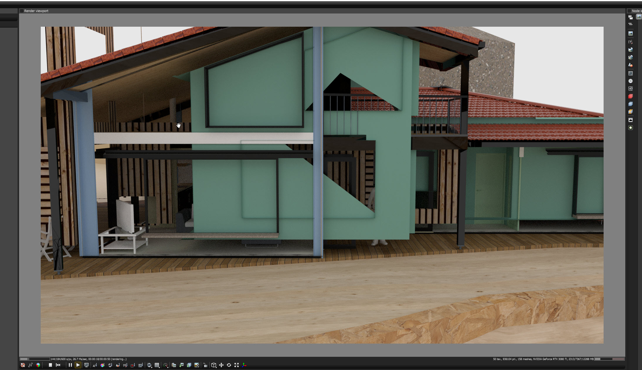

i've tried the "architectural glass" from Live DB and the problem still remains. You can see that in the Studio Standalone

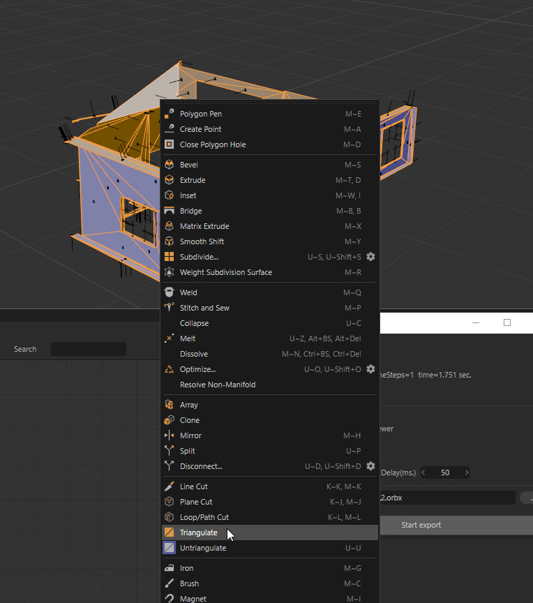

Also don't use this camera setup without baking to keyframes. It's like moving randomly.
I found this mesh is bugging it, looks like faces are with bad ordering. Probably you need to fix this mesh
Posts: 16068
Location: Türkiye
Apply this triangulation to the model that's solving the face misordering.

I disabled the fachadas Vidrio-Claro object, which is the glass, yet I still see these other shapes when I export to Standalone. That indicates there is another object in that same section, which has the material Pintura 21 or Pintura 22 applied. Upon further investigation, I suspect it is one of the objects in Pintura 21 causing the issue. Looking at the meshes in the objects with that material applied, the tesselation of those objects is not ideal. Likely fachadas Pintura-21. I would not be surprised to see an errant point in that object. Usually issues like these are geometry-related.
I have confirmed this by disabling that object and exporting to Standalone again. Bad geometry, which you will need to address. The Mesh Check command in Cinema is helpful for cleaning up these issues. Fortunately, this is a very simple shape, and you should be able to resolve the bad geometry rather quickly.
