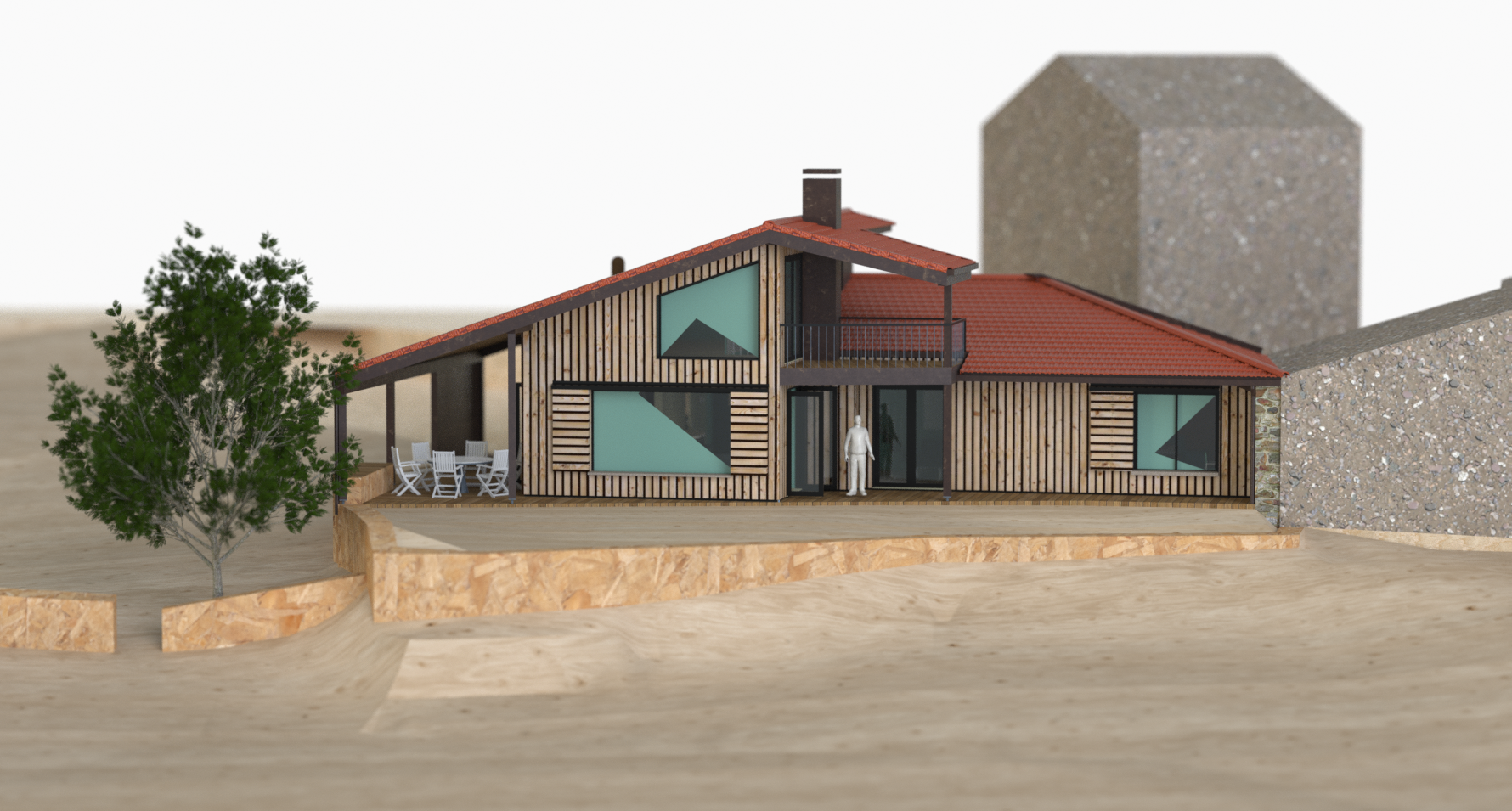

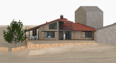

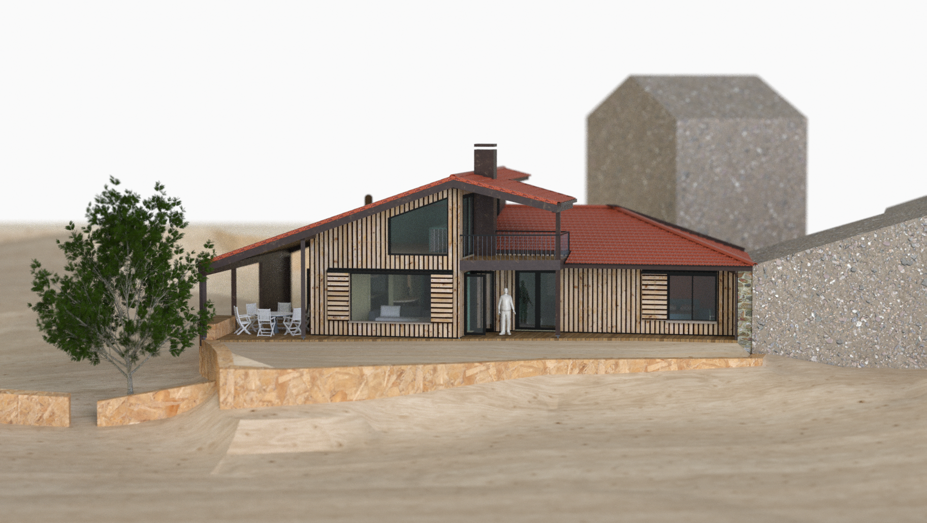

i render this scene in c4d r25 (2020.5 or 2021.1) and everything is fine.
Then i export as animated package (orbx) and open in studio standalone (2020.5 or 2020.1) and it appears something wrong in the glass material..
Can anyone help me? which parameter is wrong?

If i export the scene as "Package (orbx)" i mean 'non animated', it looks correctly in OctaneRender Studio

Hi Ahmet. i don't understand what do you mean. i'm doing tests with other glasses and nothing changes.
Sorry, i'm lost trying to solve it..

i've tried changing glass material:
- projection to cubic
- side to frontal
- tile unactive
Ahmet, i'm a simple useless architect.. nested dielectrics? :shock: i just give up
It's very embarrasing but i will put orbx file here just in case someone can test it and also the c4d file.

salmon
Posts: 42
Joined: Sun Jun 30, 2013 3:50 pm
"you have a Scattering Medium applied. What purpose does that serve for this scene?"
Hi Jay,
I don't know what's that. I've taken the material from a purchased octane material database. I supose pixellab or gsg.
I'll take a look in the manual to understand what that means.
But i've change the glass to another from Octane LiveDB and the error is still there.
Something can i try?

aoktar wrote:I cannot check it yet because preparing new builds but it may be some face overlapping with hidden objects.
No worries Ahmet. I understand it. Thanks anyway.
I know everyone like me have the problems in such a hurry.
I model in archicad so there are two planes of glass in the windows. I've deleted the plane inside the house but nothing changes.
The thing is i've a small computer to render all the frames so i was trying to use RNDR. Thats because i've noticed about this error.
