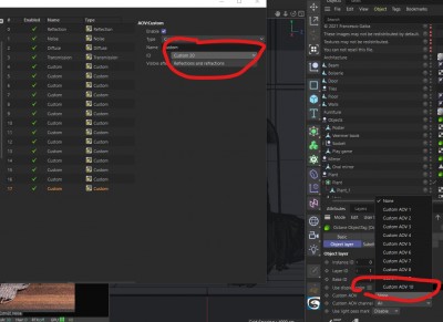

One question: shouldn't the AOV custom max ID be the same in AOV manager window and Object tag window?

Kalua wrote:Hi, Aoktar!
Thanks for the R2 upgrade! It is working great!
Regards,
Yes surely, seems like that something forgotten by me. Sorry too much changes and places to check. I'll fix that, thanks for asking!
