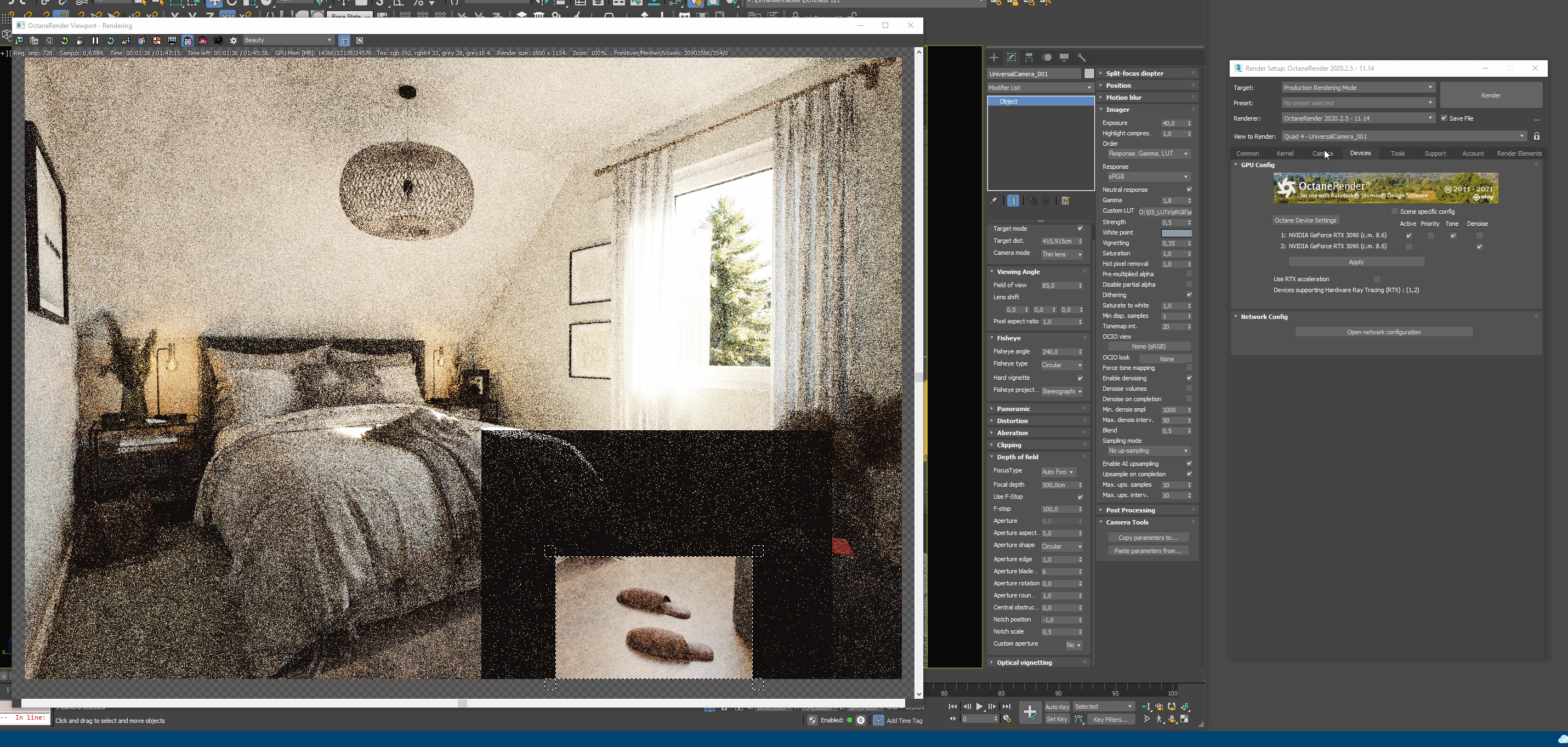

I still have this annoying problem, it is impossible to use max while rendering

i remember last year when the render was on and i could keep working, changing materials etc... now in any kind of scene, everything just gets stuck
Just to remind I have 2x 3090 128Gb of ram ... I have already left the card that is connected to the monitor off for the rendering

if you are rendering you can forget that octane also updates the mtsl and maps preview

samsue wrote:if you are rendering you can forget that octane also updates the mtsl and maps preview
Hi samsue,
The slow max viewport should have been fixed in 12.07.
This was most visible on scenes with a large number of textures, as there was unnecessary updates.
There is still a slow UI issue from the main render settings dialog; It should be fixed in the next release.
