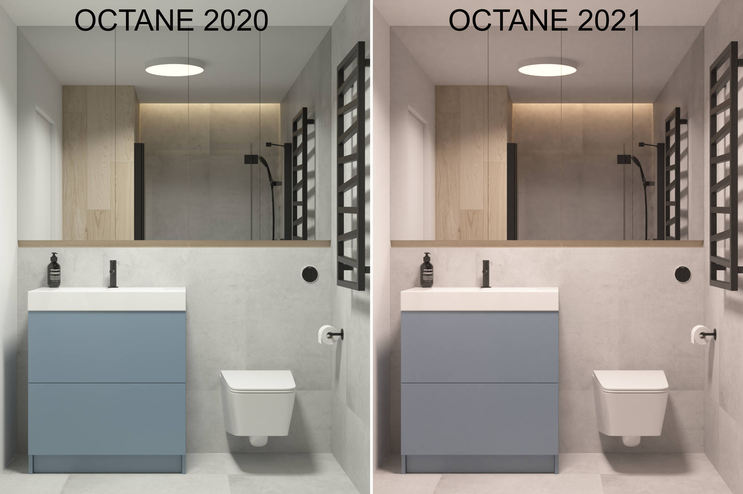

I just updated my Octane to the new version and ran into 2 problems:
1) Texture maps are not displayed correctly in Rhino viewport - Rhino uses roughness maps instead of diffuse textures. Is there an option to select the texture I want to use in the rhino viewport or is this just a current issue?
2) Renders come out different than before (light or colors) - is there any setting I should change by default?

Hi - can you please send me the scene that you posted the screenshots above from.

Set the Kernel->White Light Spectrum to Legacy/Flat to render as per Octane 2020.
