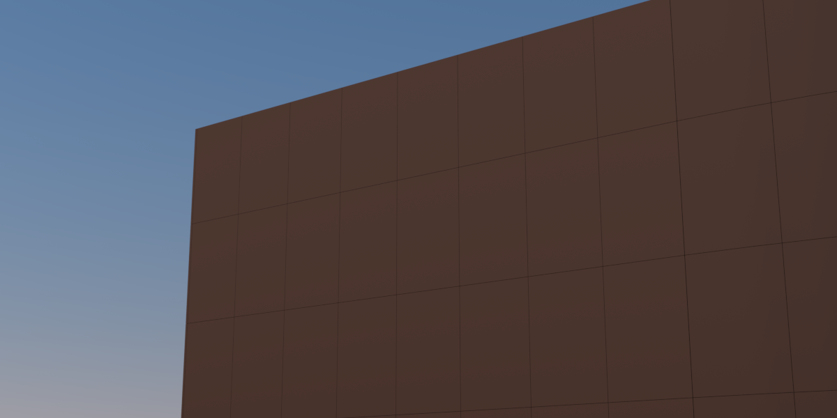

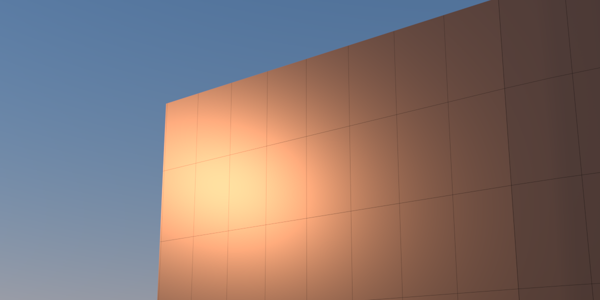

I am having issues with the specular component of the shaders.
The specular part of the material randomly disappears when moving the camera.
Attached are 2 images, one looks normal the other I get when I move the camera a little bit to the side.
I am using RTX 3090 and Nvidia driver 466.47

manalokos wrote:I am having issues with the specular component of the shaders.
Im on a 3090 + 471.11 and tried to set up a similar example but cant reproduce the problem. Can you share an orbx?
Can you answer the following questions:
1. Can you provide a scene?
2. Can you reproduce this problem when you switch RTX off?
3. Are the normals on the box flipped (pointing inside)?

Dear Wallace,
With RTX off it behaves normally.
I will send you an example scene right away by private message.

manalokos wrote:Dear Wallace,
Kind regards
Filipe
Thanks!
I can confirm that this is a bug I have fixed a few days ago. The fix will be in the next release.

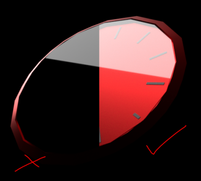

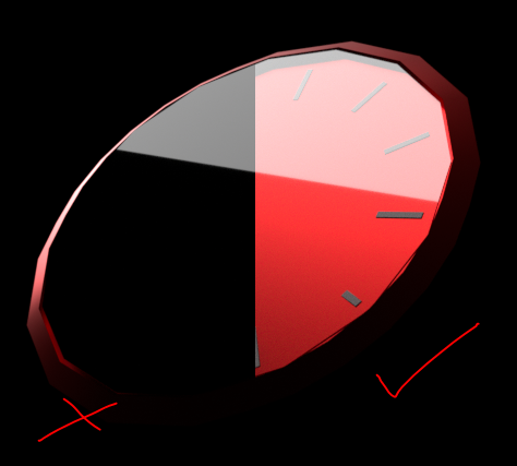

BUG: RTX on using 3090 renders incorrect glass in this example
I'm noticing some of my old scenes look broken with RTX on again on a 3090. Here is a simplified scene. The glass is no longer transparent with RTX on. RTX off is ok.
I'm using 471.11 game ready driver
rtx_on_3090_glass_bug.orbx
(150.43 KiB) Downloaded 179 times

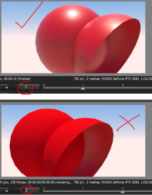

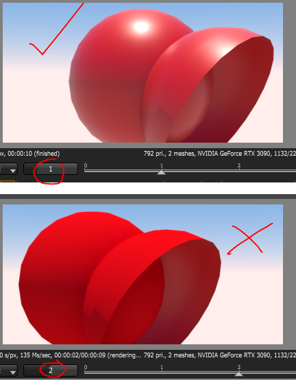

BUG: Vanishing specular reflections with RTX on using 3090
Im pretty sure this is the same bug manalokos was running into, but just in case it's not, here is a sample scene
Load the scene and scrub from frame 1 to 2 and you will see the specular highlights vanish.
I tested with a 3090 + RTX off, and a 1080ti + RTX on and it works correctly.
rtx_on_3090_spec_highlight_bug.orbx
(137.52 KiB) Downloaded 227 times
