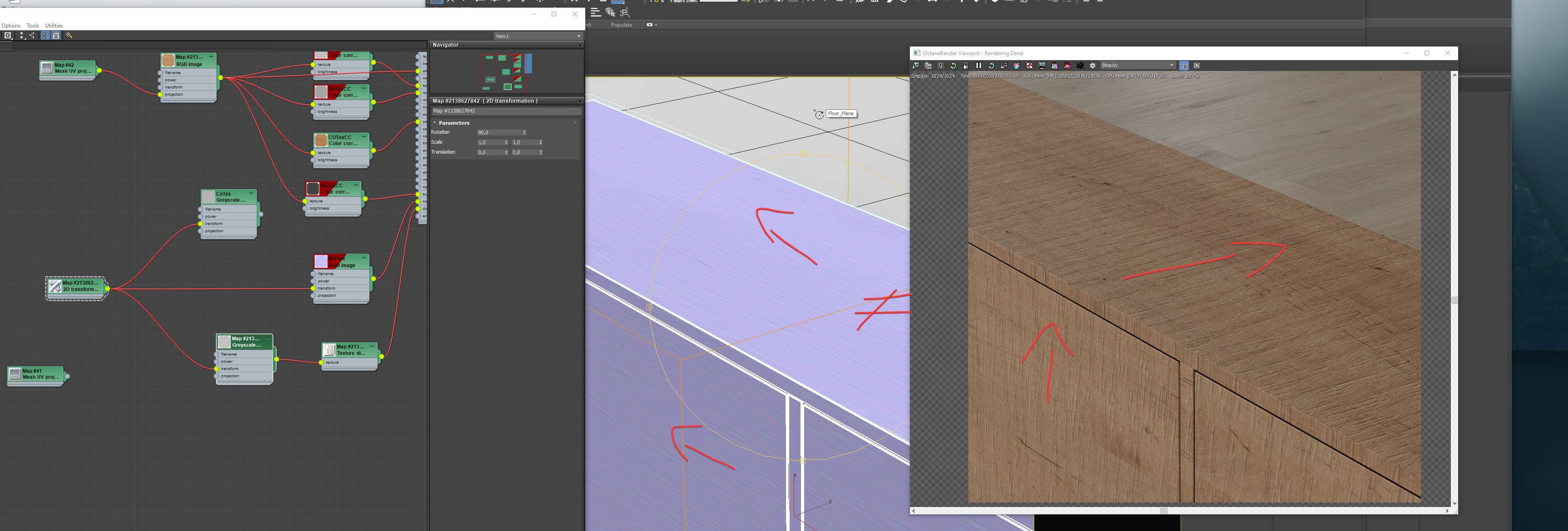

Hi Sidches,
Yes, that's right, the update of the texture transformation in the Octane viewport doesn't work in this version.
Sorry about that! This is a known issue from the Octane engine, and will be fixed in the next release with 2020.2.2
Thank you

viewtopic.php?f=80&t=77319&start=30#p398865samsue wrote:- Texture looks different from the rendering in max's Vieport.
- Mesh UV Projection, not working, at least not for me.
Hi Paride, your link seems not good
