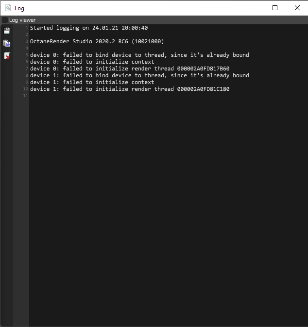

When I click "Open Octane Viewport" then close it - I saw this... And can't start the next IPR render. This happens in each scene =)
As I understand, this will be fixed in the next version?
Thank you
