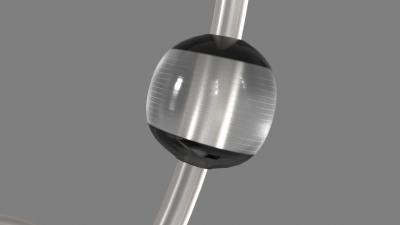

hi ahmet,
during setting up a project i find a strange behavoir with refractions:
rendered with oc 2020.1.5_R4
and rendered with
2020.2-RC5 (Preview release)
is that a known issue?
if you want i send you the projectfiles via PM

There seems to be some intersecting speculars there. Have you tried to disable the new <<nested dieletrics>> feature? Or pherheps play with material priorities?

hi kalua,
disabling "nested dielectics" works!
i doublechecked the geometry: no intersectictions or some other nasty stuff. i also played
with ray-epilon-value: no effect.i have to disable "nested dielectics" to get rid of this render-failure.

It is no render-failure: You must set priorities values to those materials, because you seem to have a specular shader intersecting another body with different shader. You will find the priority value in shader's common tab.
