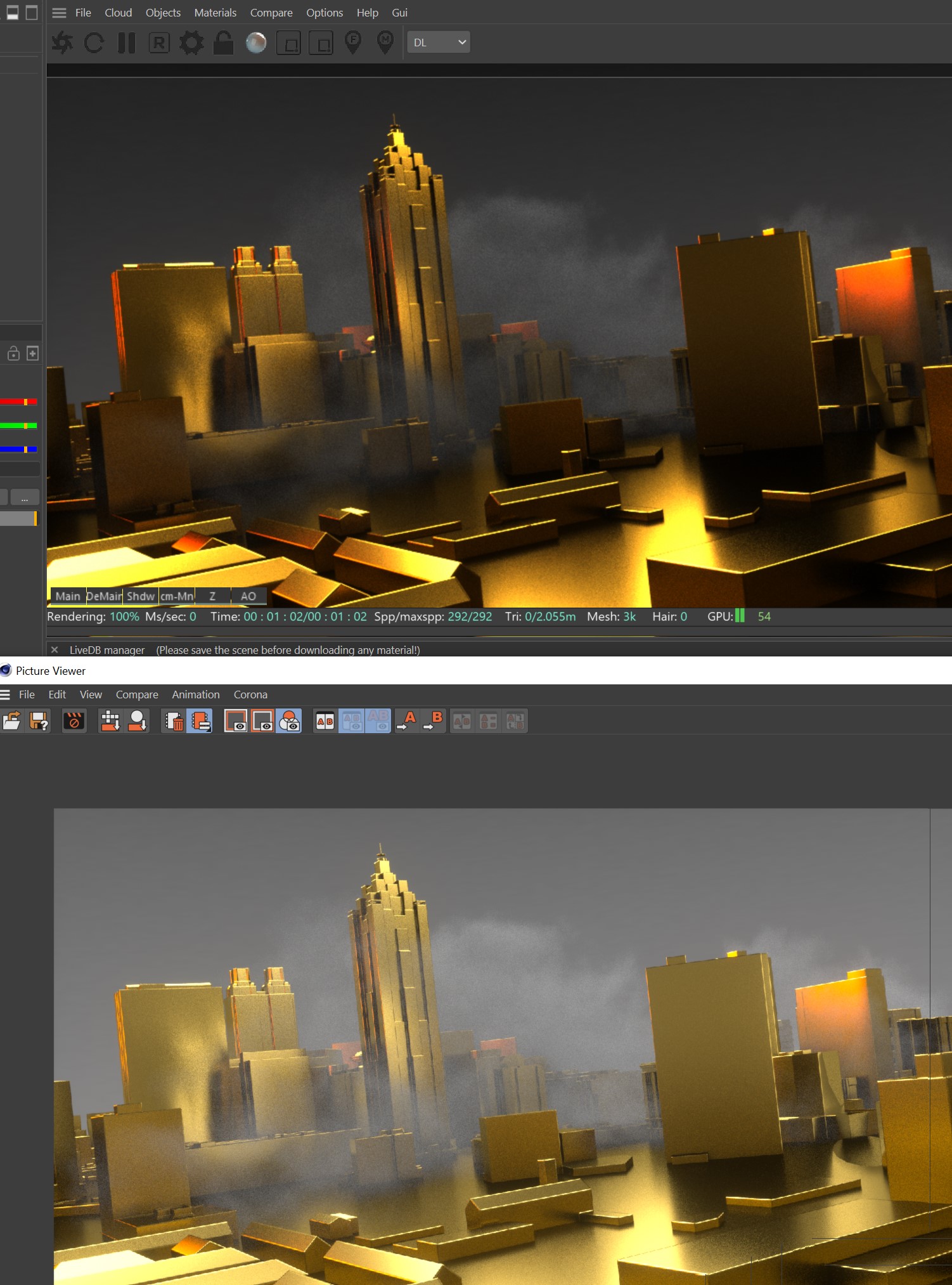

I have the same problem. Render Buffer Type is set to Float (tonemapped), the liveviewer setting is set to HDR tonemapped. Any ideas?
Picture Viewer
Picture Viewer
Live Viewer
Live Viewer

madmandrax_1 wrote:I have the same problem. Render Buffer Type is set to Float (tonemapped), the liveviewer setting is set to HDR tonemapped. Any ideas?
Put your scene without any content, just current camera and keep render settings. Then I'll say what's wrong

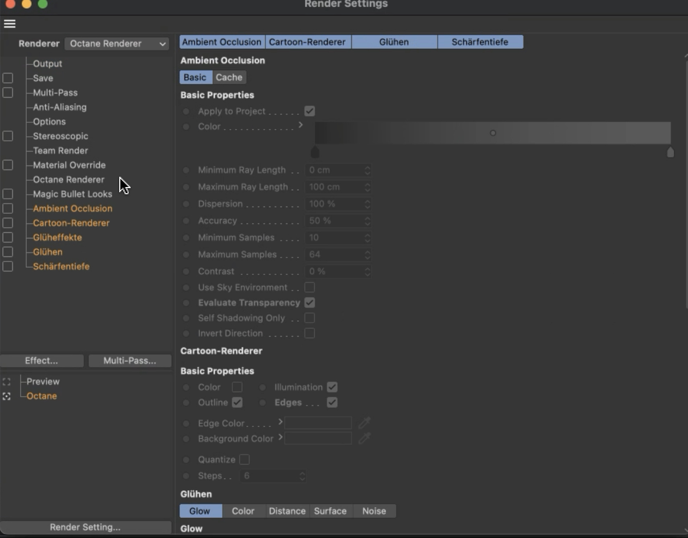

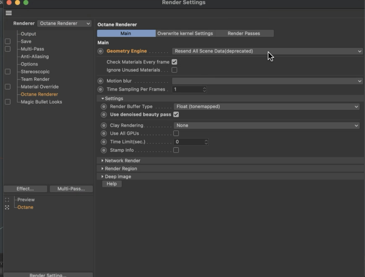

Hi madmandrax_1,
you have not shared the HDRI, so the light cannot be the same, anyway, please avoid to mix OctaneRender settings with other render engines settings:
And set the Geometry Engine to “All objects movable”:
Looking forward for your feedback,
ciao Beppe
Posts: 16068
Location: Türkiye
Deprecated options are meaning they will be removed sometime later.
Also, disable "use denoised beauty pass" for trying. Render passes are linear by default.
madmandrax_1
Posts: 8
Joined: Tue Nov 03, 2020 6:05 pm
Thanks Beppe! Delecting the unused render setting sections did the trick. I'm surprised, that unchecked render options have that much effect. Now my picture viewer and live viewer output is almost identical.
