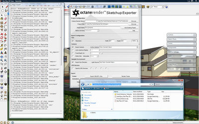

Hi Tig
No dice im afraid
Have saved model onto desktop as follows:
C:\Users\Paul Scaife\Desktop\Test Mollington\
You were right the original path name had 'A' in the folder location on our server.
Latest screen grab attached showing exporter, ruby console (still has error) and project path in explorer.
Regards Scoob

Scoob
I think that was a red-herring... :roll:
The error is occurring because it's trying to find an extension of an image-file ['fileExtname'] when it's exporting a texture.
The crash with the 'out of range thing' is because it's not finding a file-path for the texture image that has an extension on it ??
I can trap for this... BUT if a material has a texture then that texture's original image file-name is always either represented by a full-path or a file-name - with type suffix... There should never be a texture without a file-path/name associated with it...

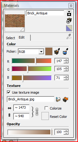

See this example
You said you had a texture image that didn't appear in the folder -that looks like the one making the problem - edit that - and see if it has a file-name properly set - if so then it's weird.
If the file-name/path has accented-characters etc in it then that might cause a glitch - if so try editing the image, save_as without them and reusing that - retry...
You might check all textured materials image file-names if it keeps happening :?
I can probably allow for that in an update...
If 'not' then try editing the image and resetting it [you need to specify an image-editor app in your preferences beforehand [I use Gimp]] - TIP: the edited image is put into C:/Users/Scoob/AppData/Local/Temp/ - sort by date an it should appear near the top of the list as say 'Brick_Antique.jpg'
