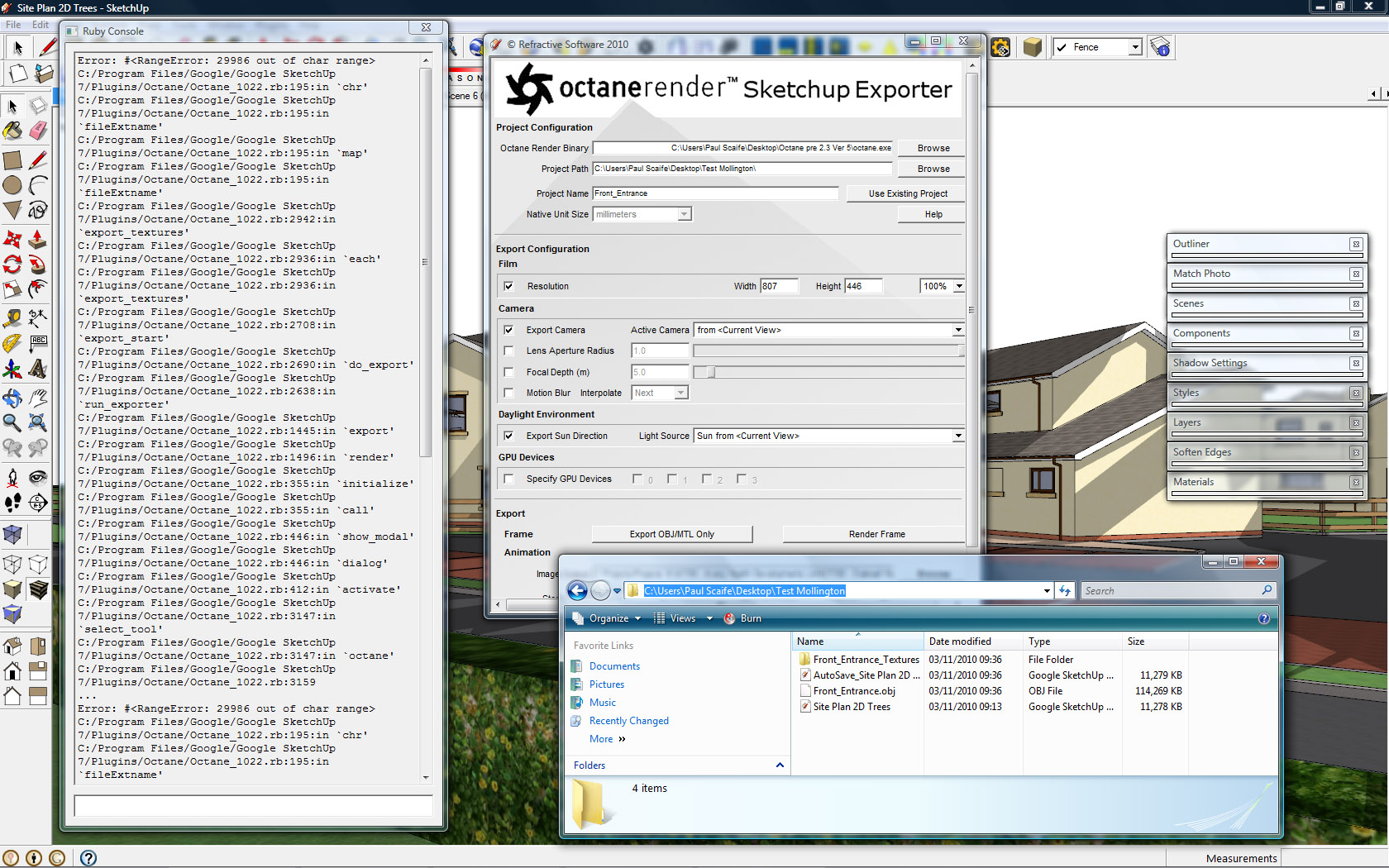

Have saved model onto desktop as follows:
C:\Users\Paul Scaife\Desktop\Test Mollington\
You were right the original path name had 'A' in the folder location on our server.
Latest screen grab attached showing exporter, ruby console (still has error) and project path in explorer.

No dice im afraid
