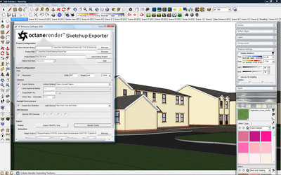

Hi Tig
I have tried again this morning on this file but cannot create the octane render specific files (only mtl & obj files are created) when i Hit 'render frame'.
After the export nothing happens, I just shut down the export dialogue.
I have tried to deleted the site around the building and reset the binary to the 1.022 version. Not sure how this will effect the export though (as it's not creating th eoctane files?)

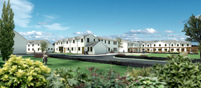

To be clear, i have made many renders with the exporter but this model seems to be causing problems. I attach a previouse render.
Could it be the model?

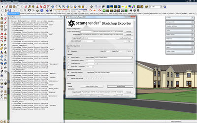

If you run the Exporter with the Ruby Console open are there any error messages ?
Yes at the top of the console window. Out of range?, please see attached screen grab....
