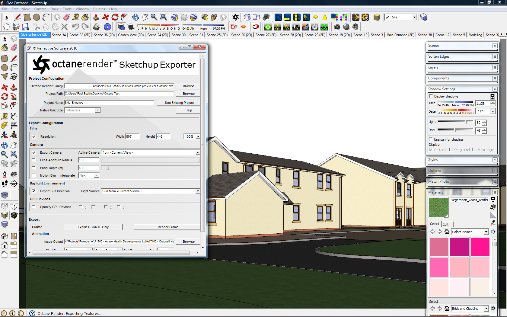

PS. This is my exporter setting for info. When I look in the target diretory on the desktop I have a 129,000kb obj file and a directory with the textures (although about 75% of the textures are not included) & the sketchup model.
Can you please help?
Cheers Scoob

Before we start... to stop your dialog needing scroll bars... with Sketchup closed Open the Strt > Run 'regedit' and find this key
HKEY_CURRENT_USER\Software\Google\SketchUp8\WebDialog_Octane
and delete it.
When you next run the Exporter within Sketchup it should be resized correctly...
Now for the problem...
Your settings seem OK.
If only exports the Textures of Materials in use, so unused materials textures are not exported.
Plain 'color' Materials are defined in the MTL file with no matching image.
If you click 'Export OBJ/MTL Only' you will get what you describe - plus an MTL file.
To export a render use 'Render Frame'. It should then make the equivalent files as before and start Octane.
Is the binary-path correct - notice it's to v1.2.3 - this exporter is for v1.2.2 - but it 'might' work [untried] ?? :?

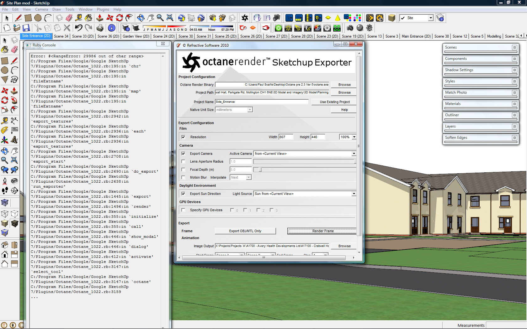

If you run the Exporter with the Ruby Console open are there any error messages ?
Yes at the top of the console window. Out of range?, please see attached screen grab....
Can you manually make a blank OCS and then bring in the OBJ that was made ?
Yes, can get object in but no materials. All one colour. I noticed that in the texture output folder for the images, a brick texture that is used for the plinth course (red) is not there
Any more ideas? could you look at the model?
One other thing i have noticed, The exporter to Thea takes 28 seconds for this model, in octane it thinks about it for several mins. Is this something that can be improved upon/optimized as development continues?
Regards as ever Scoob
