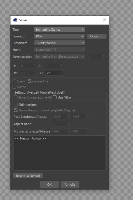

Hi Ahmet!
I'm working on this release and it's really great and more stable than previous ones. Well done man!!
I've a bug issue, btw.
I'm not more able to save alpha channel from live viewer.
I set it as usual in octane settings, once render is finished I sent it to Picture VIewer, but when I save in TIFF alpha channel is not activable (attaching screenshot) and once opened in Photoshop there's no an alpha channel and white/gray squares are part of picture...
Thanks for your help!
Cheers!
