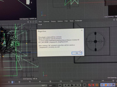

i get a pluign error.
i change from octane 2019 to 2020. And i get a crash on every load of my C4D scene. But i comes always if i load the scene or if the scene is load after i would render.
I use the latest NVIDIA Driver 07.04.2020 and the Cinema4D version 2020.1-R4 (Stable release)17.05.2020 version.
My Hardware specs:
2x Titan RTX via NVLINK
Windows 10 with all new UPDATES
CPU=AMD Ryzen Threadripper 1950X 16 Core
Cinema 4D R21
So can you please Help me to fix the Problem very fast?
I can not work with this error. Bevor it works with 2019 but if i downgrade tot he last version it doent work like in the past.
Here the Bugreport from octane:
My Hardware specs:
Cinema 4D R21

Startup language : en-US
Processor : 6(12)x Intel Core i7-6850K CPU
Computer name : SLAVE1
Thread Count : 12
Cpu Speed (MHz) : 3600.000
Application Type : Modular
Command line arguments : "C:\Users\admin\Desktop\project.c4d" "-exportORBX" "C:\Users\admin\Desktop\project.orbx"
OpenGL root context initialized
Vendor : NVIDIA Corporation (NVIDIA)
Renderer : GeForce RTX 2080 Ti/PCIe/SSE2
OpenGL version: 4.6.0 NVIDIA 442.19
Driver version: 442.19
Vendor : VMware, Inc. (VMWARE)
Renderer : Gallium 0.4 on llvmpipe (LLVM 4.0, 256 bits)
OpenGL version: 3.3 (Core Profile) Mesa 17.0.1 (git-)
Driver version: 17.0.1 (git-)
delete file:bugreport_20200506_175223.zip
Creating zip file:C:\Users\admin\AppData\Roaming\MAXON\Cinema 4D R20_4FA5020E\_bugreports\octane\bugreport_20200512_165137.zip
Adding file:C:\Users\admin\AppData\Roaming\MAXON\Cinema 4D R20_4FA5020E\c4doctanelog.txt
Loaded Octane DLL:OctaneRender Studio 2020.1 version:8010000 SDK:2020.1
Octane Render for Cinema 4D 2020.1-R2 built for:200 C4D vers:20059
C4D:20059 comp:[SLAVE1] OS:[WINDOWS 64 BIT] Windows 10, 64 Bit, Professional Edition (build 18363) opengl:460 sysInfo:34 versType:2
CPU:[GenuineIntel, stepping 1, model 15, instruction family 6] speed:3.6 GHz numOfCpu:12Ht
Plugins:[... ]
NVAPI initializing...
NVAPI Version: NVidia Complete Version 1.10
Nvidia driver version:442.19 [r440_00]
Loaded 174 osl scripts from dir:C:\Program Files\MAXON\Cinema 4D R20\plugins\c4doctane\res\osl_scripts
Export orbx:C:\Users\admin\Desktop\project.orbx start:-1 end:-1 step:0
VRAM used/free/max:0Kb/11Gb/11Gb Out-of-core used:0Kb RAM used:3.971Gb total:63.922Gb OpenGL free/total:0/0
ProcessUpdate(flags=M cAsyn=0 dDelay=0
1-Start Orbx Export....
<< exportAnimatedORBX >>
SendAndStartRender(aDoc=dad3a740, cDoc=dad3a740, renderMode=1, fullSend=0, rendSettings=0)
: No error
FumeFx library initialisation error!
sendSceneToOctaneRender(renderMode=1, fullSend=0, settings=d96dc880)
: No error
--------------------------- EXPORT LOG ---------------------------
ResetAndInit 1
resolution=0*0 [OK]
: No error
ResetAndInit [OK]
readPrmsFrScn(1)
: No error
Scene created in plugin version 4040000
Scene plugin version is older than version:2020.1-R2
Plugin will convert the parameters of displacement texture.
Animated attributes should be changed by manually!
doVersionConvertion(vers=4040000)
: No error
readPrmsBC 11111: No error
Multi-threaded material conversion, thread count=10
