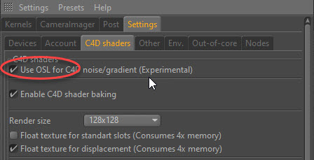

Just checking - are C4D noises supporting GPU now? It says so in the above release notes but I also remember seeing in a previous release that it would not be available until 2020.2.
Cheers mate.
Posts: 16068
Location: Türkiye
protokol wrote:Thanks for the latest release Ahmet.
Cheers mate.
yes since a few 2020.1 builds, RCs. Needs to activate this parameter.

Sorry I should have been clearer, I meant is it still experimental as I've had a couple of issues with it.
Can you confirm which check boxes we need checked -
1. Use OSL for C4D noise/gradient
2. Enable C4D shader baking
I'm trying to determine what 'enable shader baking' does as I don't see any difference when i turn it on and off while using a c4d noise. The wording suggests to me that it still uses the old method of baking out a noise rather than doing it procedurally on the GPU.
Or does turning on Use OSL for C4D noise/grandient override the other check box?
Thanks for clarifying and the hard work - cheers!
Posts: 16068
Location: Türkiye
protokol wrote:Sorry I should have been clearer, I meant is it still experimental as I've had a couple of issues with it.
can't check it right now but keep both selected for being sure.

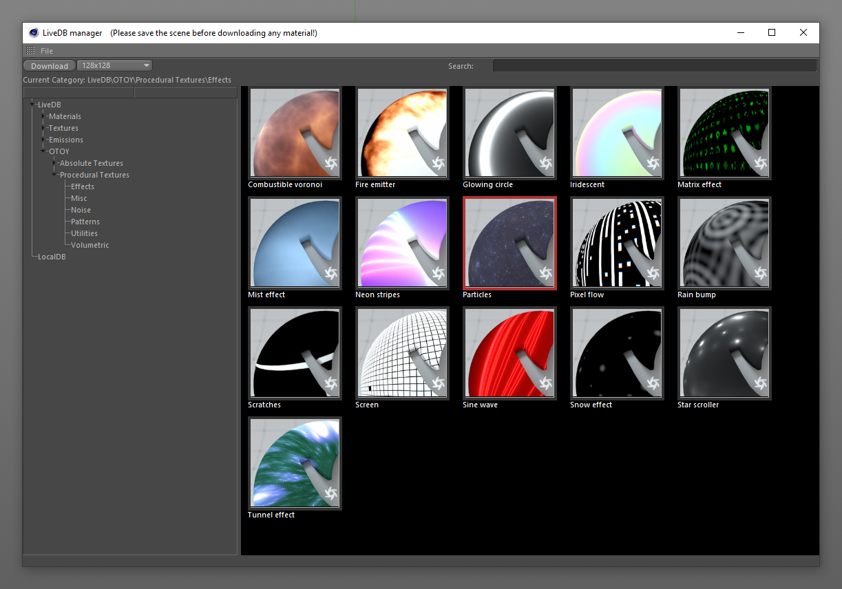

Hi Ahmet, can you explain how to use OSL textures in LiveDB? I click to download, but it seems not right way to use it.
Posts: 10604
The OSL procedural nodes in LiveDB are texture nodes, not materials, drag and drop them in the node editor to use them.
ciao Beppe
