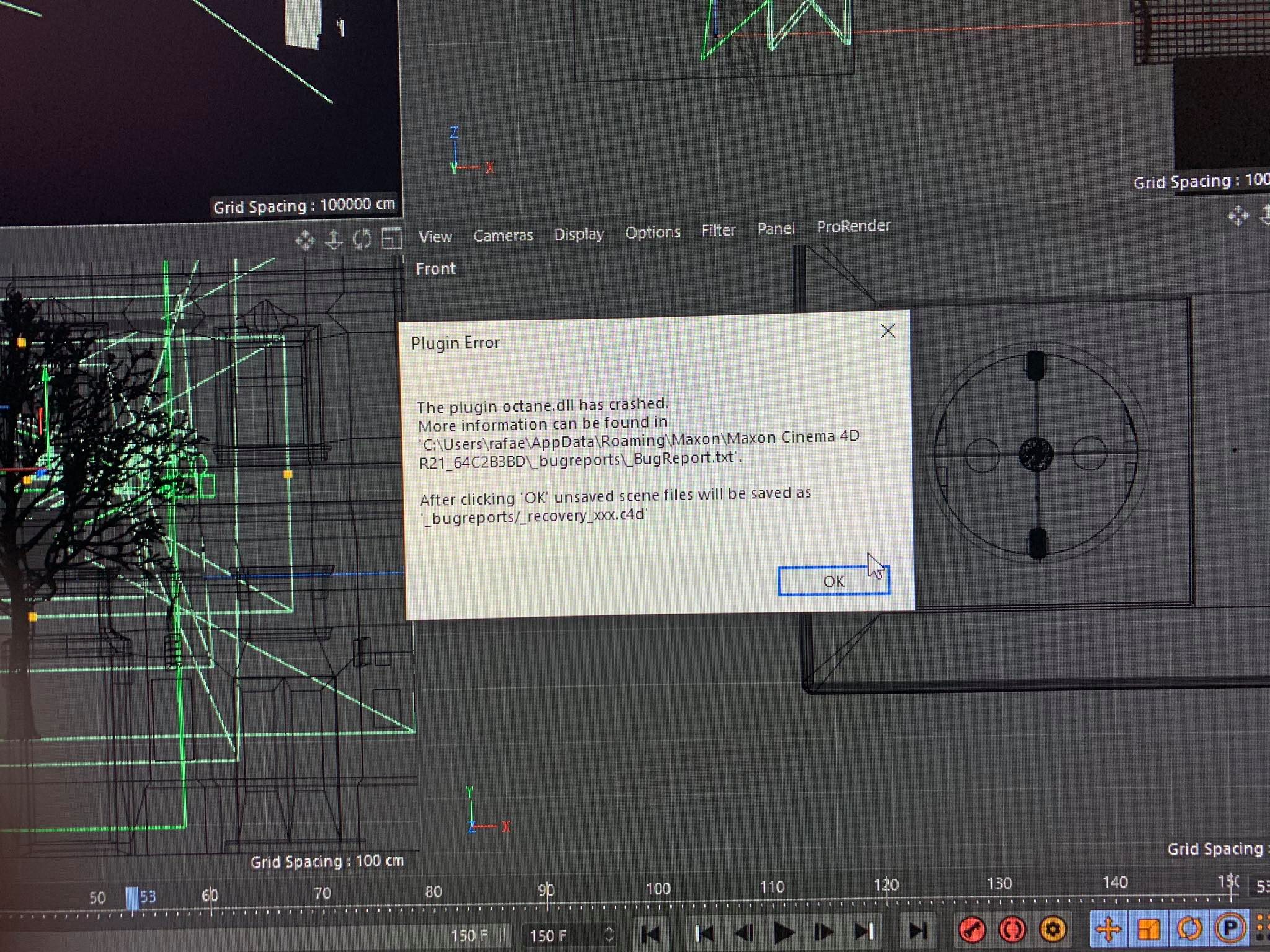

i get a pluign error.
i change from octane 2019 to 2020. And i get a crash on every load of my C4D scene. But i comes always if i load the scene or if the scene is load after i would render.
I use the latest NVIDIA Driver 07.04.2020 and the Cinema4D version 2020.1-R4 (Stable release)17.05.2020 version.
My Hardware specs:
2x Titan RTX via NVLINK
Windows 10 with all new UPDATES
CPU=AMD Ryzen Threadripper 1950X 16 Core
Cinema 4D R21
So can you please Help me to fix the Problem very fast?
I can not work with this error. Bevor it works with 2019 but if i downgrade tot he last version it doent work like in the past.
Here the Bugreport from octane:
