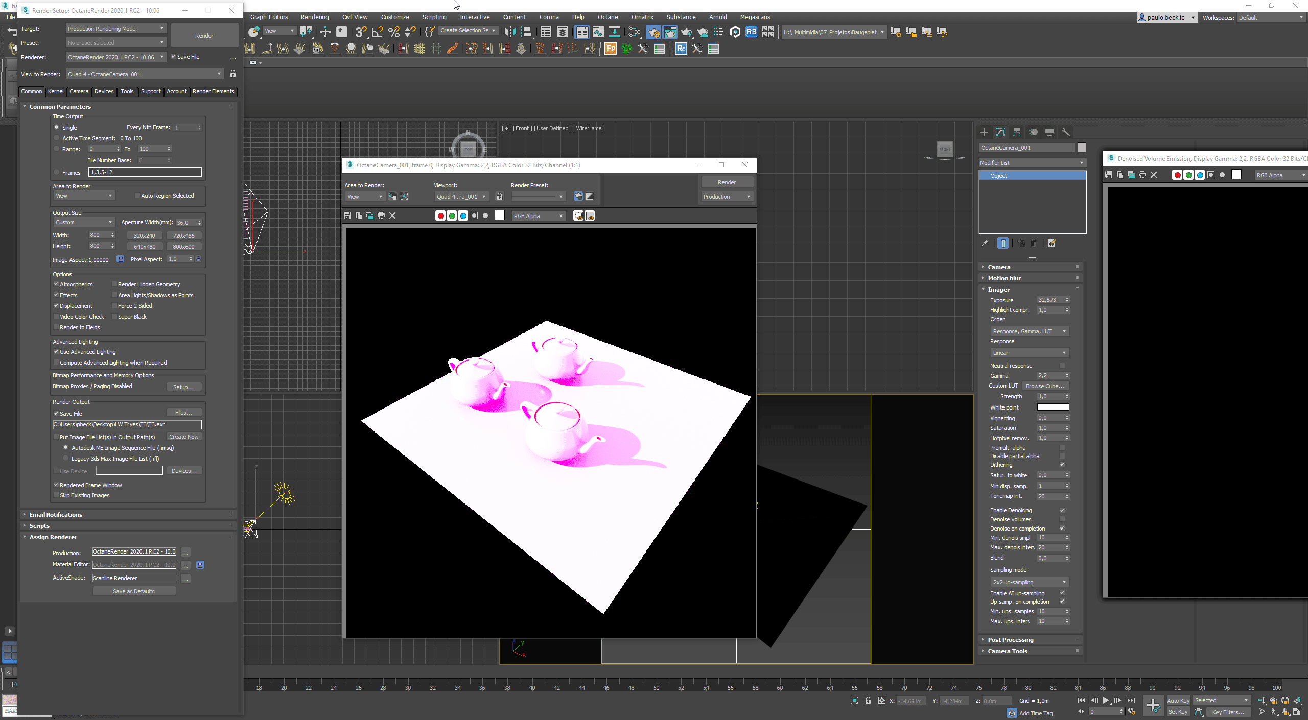

I've tried every possible combination.
only works if I mark "Save all render passes to single ... "
and I don't want to save everything in just one file, besides everything, overload the ram memory of the PC.
samsue
Posts: 393
UPDATE:
several hours trying to do it the "right way" using, like its says at poupup note "Imager> Nonlinear tone > Decrepted. Please keep ON .. "
I figured, why not deactivate and try to turn it off, big surprise, now everything works, I can save everything the way it should.
so if you want to save in Linear with Octane, deactivate the Imager > Nonlinear tone mapping.
sounds like a bug to me this
PS: it's frustrating, old manual, lack of information... terrible. A lot of cool stuff but no Tutorial about things or how to use them.
I spent 1 day of my weekend reading things I already knew, trying to revise if I did something wrong
