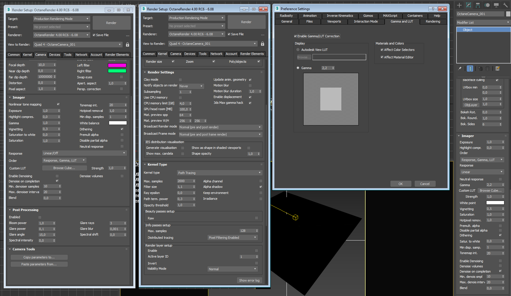

Right now, I've got the following settings:
- Nonlinear tonemapping is off, no response curve
- 3DS Max gamma hack is off
- 3DS Max Gamma/Lut Correction is on and set to 2.2
- I've changed my image textures Gamma to 1.0 from 2.2
Is this correct?
Do I need to turn on the gamma hack or turn off Max Correction?

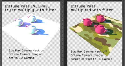

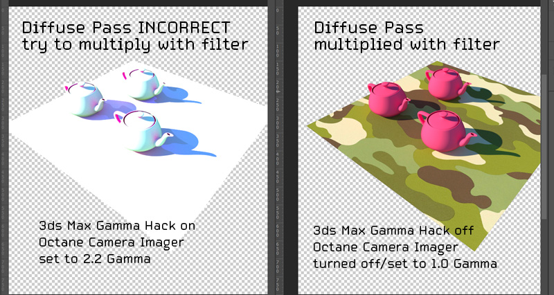

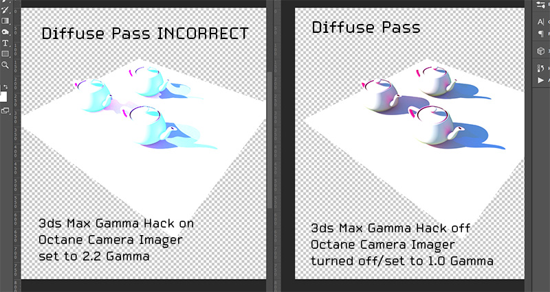

I've done a few test renders from the gamma file (exr @32). If I render simple diffuse, reflection, transmission etc passes, I can put the beauty pass back together.
If I render raw passes with diffuse & diffuse filter, it doesn't work in the gamma file you linked to. The raw diffuse pass comes out extremely overbright, and when I try to multiply it with the Diffuse filter, it will not let me.
However, if I disable 3Ds Max Gamma Hack & set the Octane Camera Imager Gamma to 1.0 instead of 2.2, it works as expected.
What is going on here? Why is this happening and which settings am I supposed to use then?

I have used exactly the same settings as you. Full float 32 .exr with no compression, and when I open it in Photoshop set Gamma to 1. I still get those completely overblown passes when I render raw beauty passes. When not rendering raw it is fine, but raw is going wrong.
I'm attaching the .exr file so you can see what I mean. The diffuse pass is unusable and blown out.

Hi Paride, the only difference is here:
I have checked the raw button because if I do not, I cannot render Diffuse pass & diffuse filter pass like described here: LINK
If I do not check the raw button, I get simple diffuse, reflection etc passes which look fine and not blown out, but I'd like more flexibility when compositing.
If I do have Raw checked like above, I get the blown out pass. I found this somewhere in the forum from when the raw passes was first released:
We added the possibility to render raw and filter beauty passes, which can then be multiplied during compositing, which allows you to modify the colour of objects in post (of course, reflection of changed object will still show the old colour). The calculation of the raw passes is done during tonemapping which means it works only if you use the linear response curve with a gamma of 1.
This sounds to me like setting the gamma to 2.2 in the Imager is the problem?
