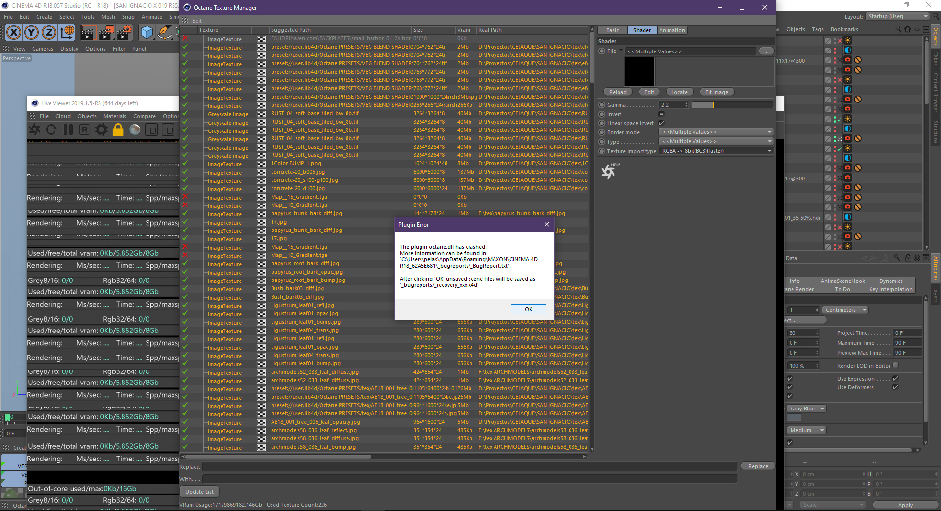

I found a crash that happens everytime I toggle multiple images "Type". The backup .c4d file generated becomes useless as it crashes again as soon as C4D reopens it.

So, is this going to be adressed? It is quite an important feature for saving Vram.
