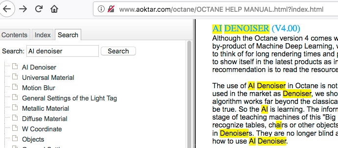

The C4D Octane manual gave me this:
Your search for "AI denoiser" returned 0 result(s).

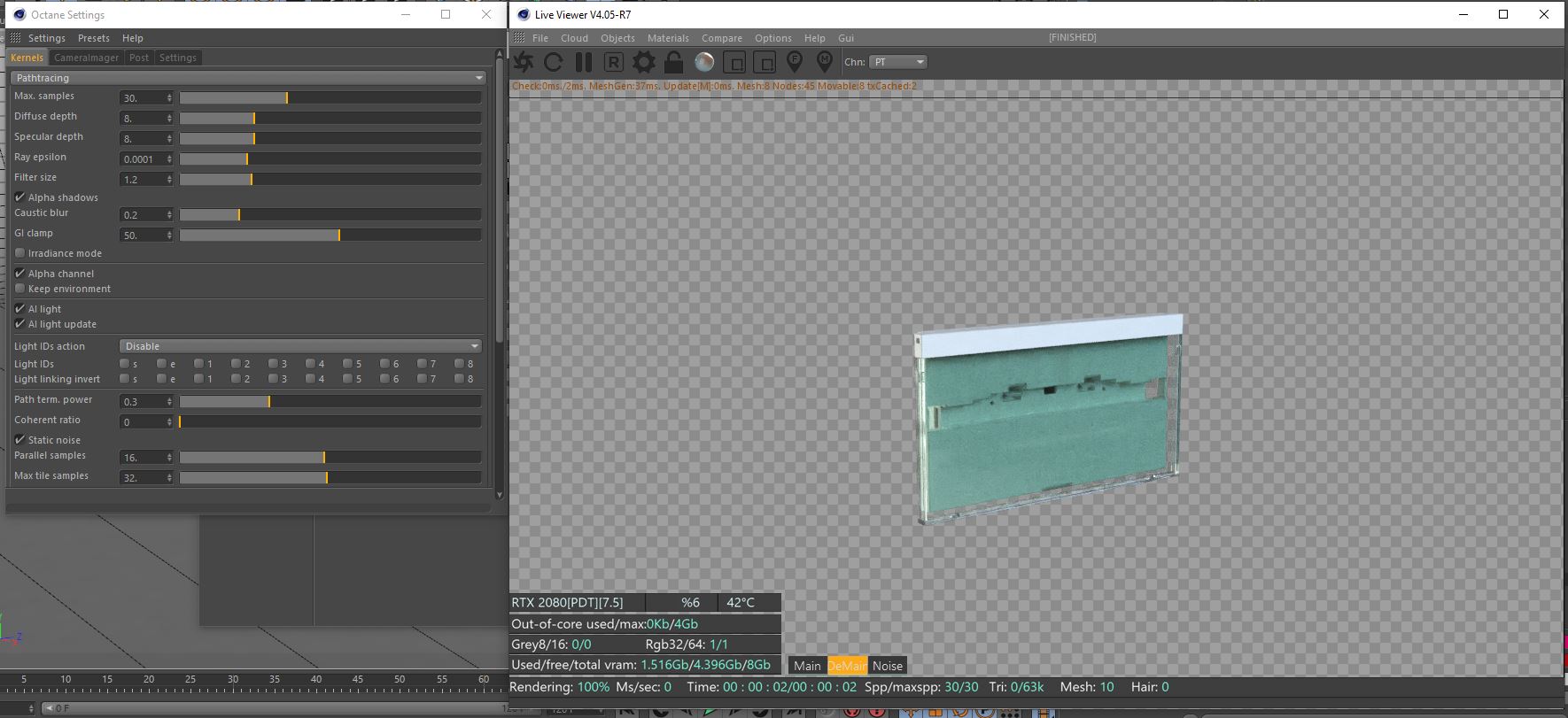

Hi everyone,
Sorry but I relaunch the Hatsize7 thread :
"I can save the denoised beauty pass. My problem is with its alpha. It looks like it's burnt in.
If it's 8bit JPG, the background is black,if it's PNG, it's transparent, but then there is a black contour around the object.
So what I would like to have is the denoised beauty pass looking like the normal beauty pass, with background, so I can blend them in post, with the alpha channel saved in a separate file (used for both passes if needed)
The only way to work with this now is to use matting/defringe (1px) in PS or refine edge in AE on the denoised beauty pass."
I read the manual, but I didn't find any solution for this question
Can anyone help please ?
Posts: 10484
please check if the Keep Environment option is enabled in the Kernel settings, and if yes, try to disable it.

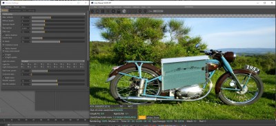

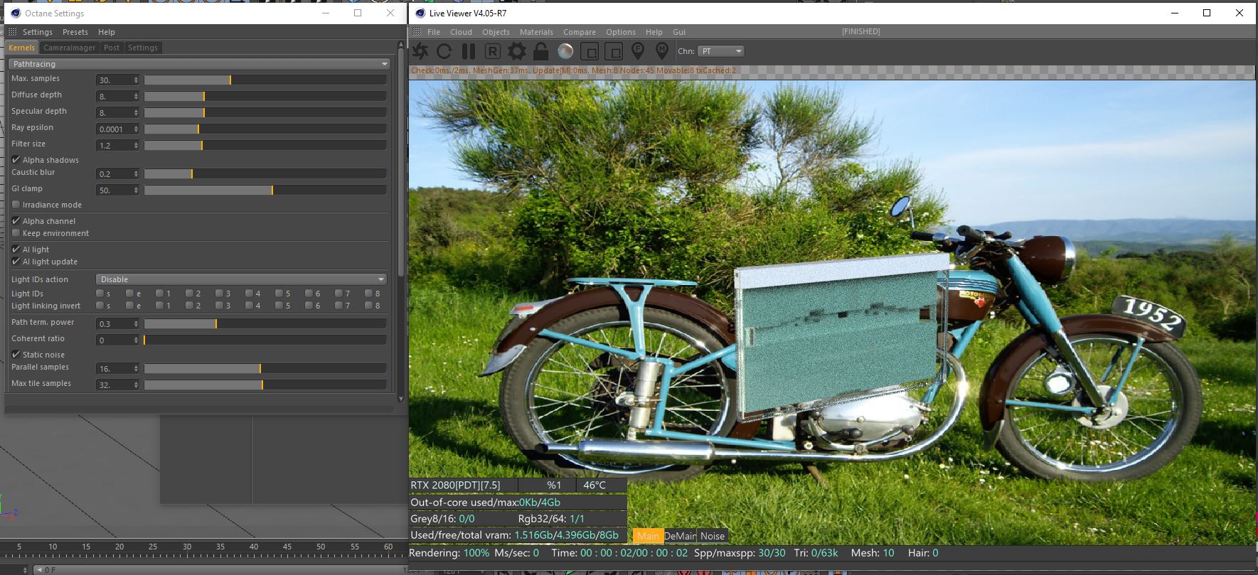

Thanks for your help Bepeg4D.
But still the same.
The thing is, when I click on "DeMain" the background goes off.
And it does the same when I check the "use denoised beauty pass"
DeMain
DeMain
Main
Main
