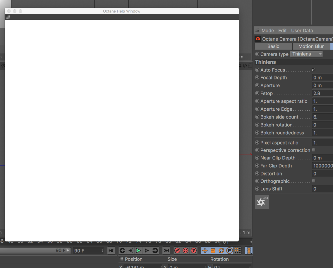

In plugin, a lot of HELP buttons can't remember how much in every octane nodes. They are directed to latest manual. And It's really saddening nobody click to this. See image.
frankmci
Posts: 917
Location: Washington DC
aoktar wrote: It's updated. I'm keeping latest manual on my server because some reasons.
Thanks for updating the link.
On our machines, the Otoy icon help buttons still do not work, leading to a blank window, like this. I have to admit it's been a while since I checked to see if they were working again. Good to know the menu based help is, although a bit less direct.
Edit: Correction, the Octane Tag based Otoy icon help dos not work, but the one found in an Octane material does.
