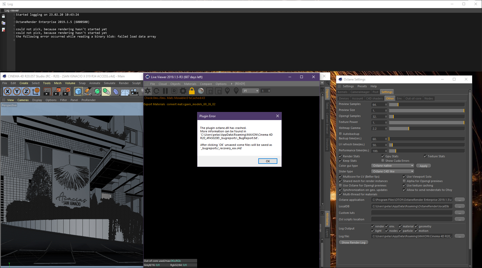

It maybe due to usage OOC and having small head room value in OutOfCore parameter.augdalmo wrote:Hello Aoktarrclassenphoto wrote:@aoktar
What is difficult to understand?
The Octane Render Plugin crashes if there is a material in the C4d project file were the path of the Texture image file cannot be loaded or is missing.
I explan this in the post bevore with sample images.
The problem always occurs, this sucks!
Yes! I have the same problem, I have observed also that Octane Texture Manager report is not correct for some files paths but It report it's OK with green check. I observed that the crashes may be due to materials for which Octane indicated the path, but in reality it did not load the textures in the previews even if the reload is done.
The path that causes the crash refers to texture in the "asset" folder which is located in the "tex" folder which is located in the folder where the C4d file is located.
I found that to cause the crash is a material that has 4 textures 7565x8500 pxls, of which three are about 15-18 MB each and one of 2.29 MB, but on Octane Texture Manager it arise to 245 MB each!
I have used this material several times in the past without problems now, however, with the 2019.1.5 version it crashes.
I have to delete it without starting the Octane plugin otherwise if I try to delete it the program crashes.
Please take note that I have opened some fliles that are 6 month older and now it crasches as I try to render, it crashes also as I try to select some material. I am sure the problem is texture. If I delete all texture and then render no crashes occur.
