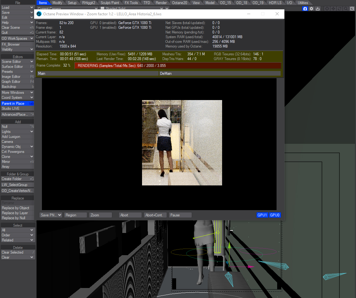

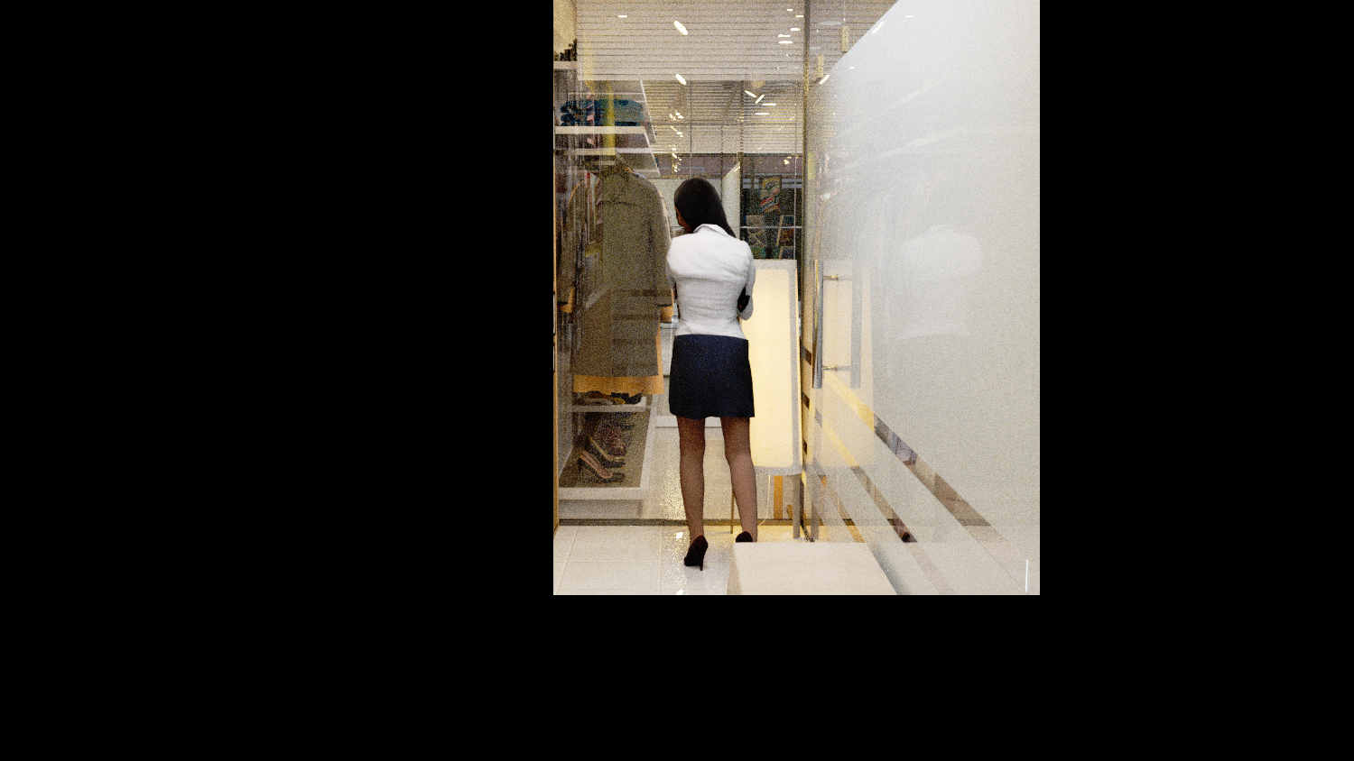

Why when I'm rendering with the native Limite region on, does Denoiser not work?

Carlos3D wrote:Why when I'm rendering with the native Limite region on, does Denoiser not work?

From what I know, V4 Denoiser did never work with limited region. I don't know if this limitation is still in use with 2020…

pixym wrote:From what I know, V4 Denoiser did never work with limited region. I don't know if this limitation is still in use with 2020…
Unfortunately, I hope Juanjo looks at it with great affection because it is something very useful for us.
In still camera scenes I only need to render the first frame in Full resolution and the rest I would render in the region where there was some movement, many times it is a very small area that the octane would render in second.
There are also those moments when there is an irregularity in the rendering, a false color in the clothes, a reflection of the light in the mirror and I would only have to render in that region.
So I avoid being rendering the whole scene in full Res from the beginning.
