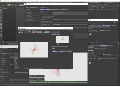

Motion blur seems to work as expected here:
Please, share an example scene that shows the issue, thanks.

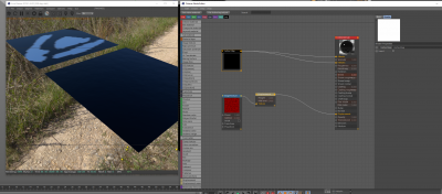

Hello, when I connect a displacement to a setup with a vertex map, it stop to influence.
https://yadi.sk/d/skvPUGPWEciRdg
