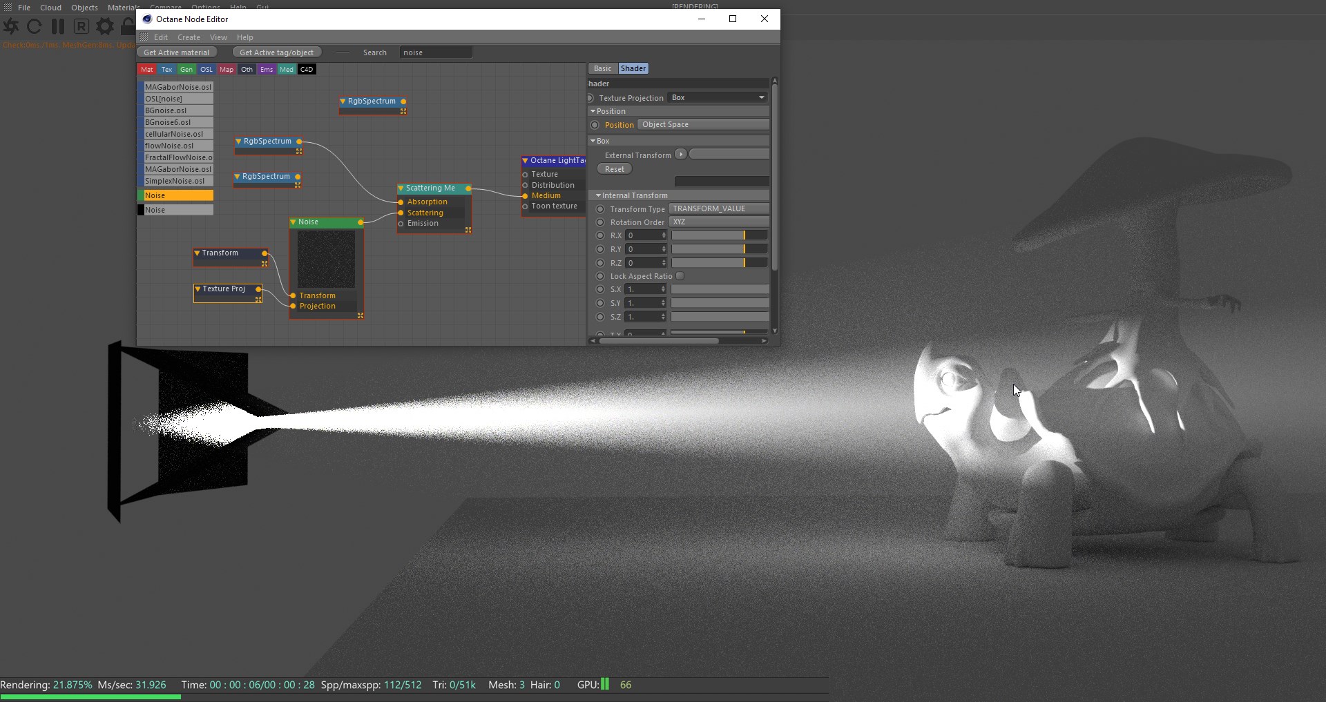

Noise doesnt seem to work inside a spotlight. I tried all projections. See image below. Is that a bug or spotlight cant accept noises in scattering? thanks

thanulee wrote:Heya,
This version is fantastic. Testing it these days.
Checked, there's a problem for internal connection of nodes. I'll try to fix it
