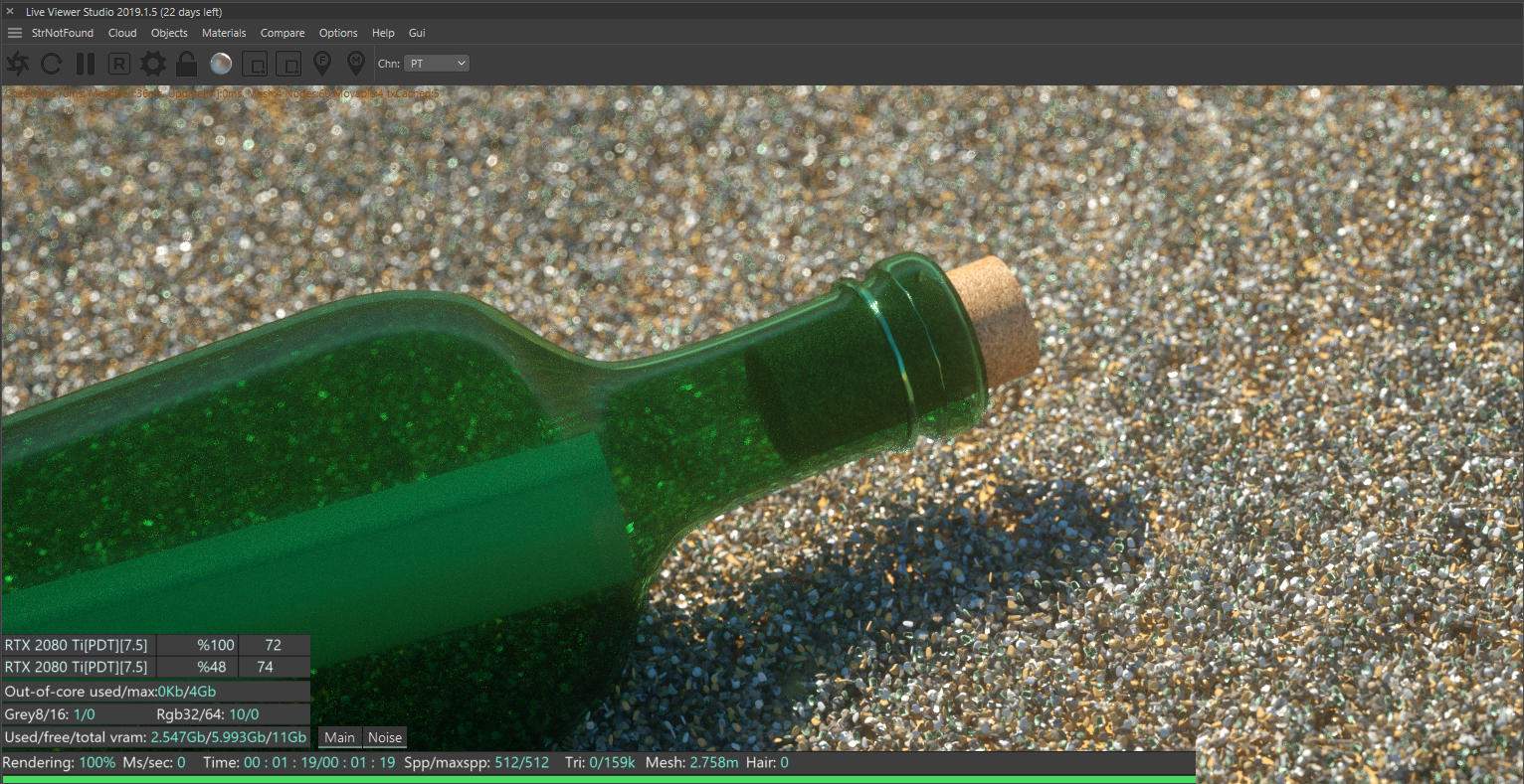

shine71 wrote:
aoktar wrote:
poison wrote:
Same with me Ahmet. wanted to try on my current project that features animated c4d noises (work in this release YES!!!) but i have lots of glass and transparency in general so that's a BIG NO NO. all comes pitch black.
materials are much much faster, absolutely lovely.
How soon can we expect that 2019.1.5-R2 ?
love.
Are you using the direct lighting kernel diffuse gi with fake shadow on the glass enabled? Also thanks!
Hi again Ahmet!
Yes, exactly.
We're using DL diffuse GI with fake shadow enabled.
Any tip?
Thanks a lot!
PS: new material conversion works like a charm!!!
Abstrax said that there was a bug in 2019.1.4 and fixed now
shine71
Posts: 137
Joined: Sat Mar 15, 2014 5:16 pm
Thanks for replying, Ahmet.
But seems to be still not fixed.
I compared several simialr scenes and glasses are always darker, with light not apssing through in same way.
Unfortunately for this workflow we are forced to use DL... :(
I hope it can be fixed
Thanks!
PS: I'm attaching a quick example to show you what I mean.
