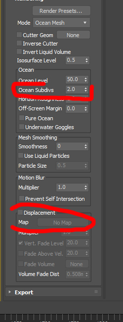

Hello guys,
I'm still having issues with the infinite ocean mesh setup with Phoenix FD, the definition of the ocean around
the liquid's grid is very very low whatever the number of particles simulated.
Thank you in advance !

Yes of course, ocean subdivision doesn't work whatever the value I set
It's (obviously) working fine on Vray next

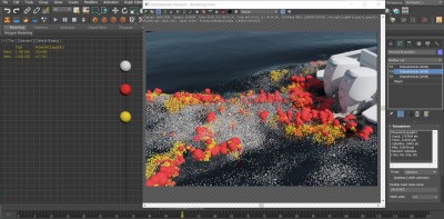

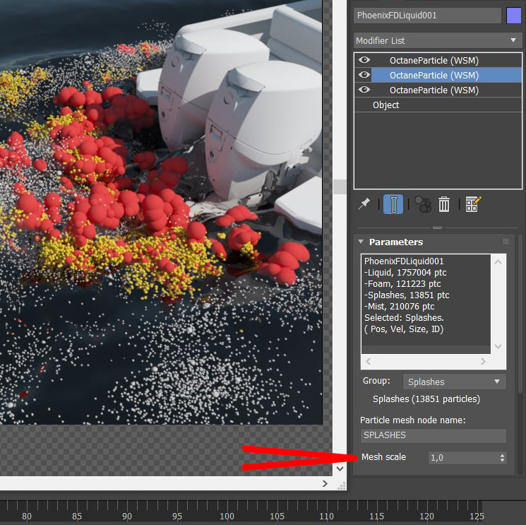

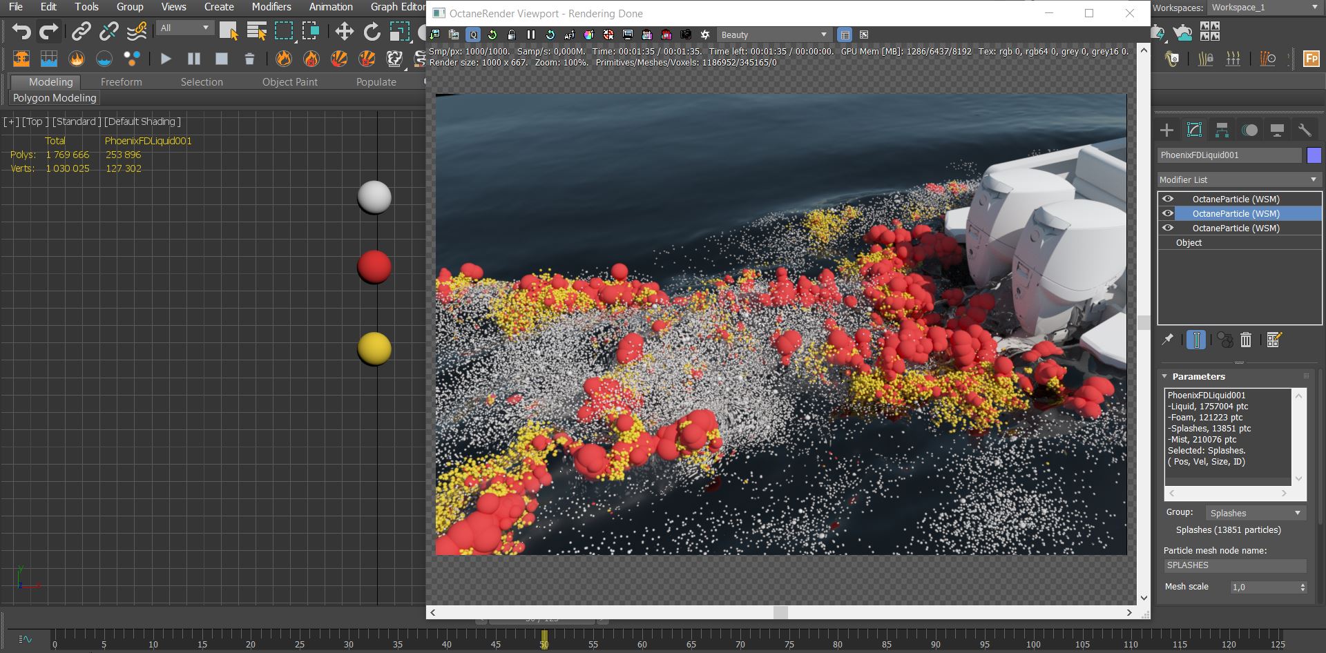

There is also an issue with splashes particles, they are 5 times bigger than foam and mist particles..

Hi paride,
yes, this is what I did
But this is an issue to fix though, for the same geometry with same scaling values, foam / mist / splashes are not rendering with the same scale.
Did you check the infinite ocean issue ?
Thx
Thx

Hi RosKos,
did you active "pure ocean" in phonexix object > Rendering > Ocean
Regards
Paride
Regards
Paride
