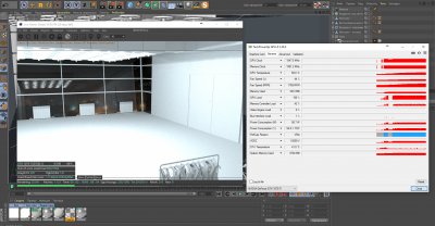

bepeg4d wrote:Hi,
please, download GPU-Z, and share a screenshot of the Graphics Card tab, thanks:
https://www.techpowerup.com/gpuz/
ciao Beppe
Ok, i've done that
On V4 everythink works flawlessly
OFC note that screenshot is done for V4.05-R6 since i can not even load texture via drag and drop or image texture COMPLETELY - i get crash even without launching LV
it happens for both 2018 and 2019
Shoul i upload logs from 2019?
I can also send scene file
Posts: 10643
GPU and Memory clock seems pretty high for GTX 1070 Ti.
Please, check to have win 10 1903, then perform a clean installation of Nvidia Studio driver 431.86, then go to Nvidia Control panel, menu Help, and enable the Debug mode.
ciao Beppe
