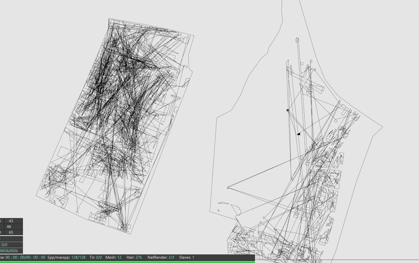

hello,
i have no idea what is going wrong but it seems as if the octane-hairrender does interprets
the splines not correctly.

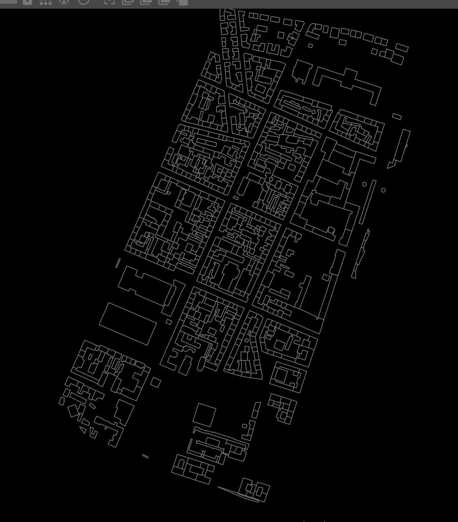

i tested it also with the native curve-mode in redshift- and it works as
expected:

It's not a 2019.1.1 issue. Multi splines with "closed" option is not supported.
