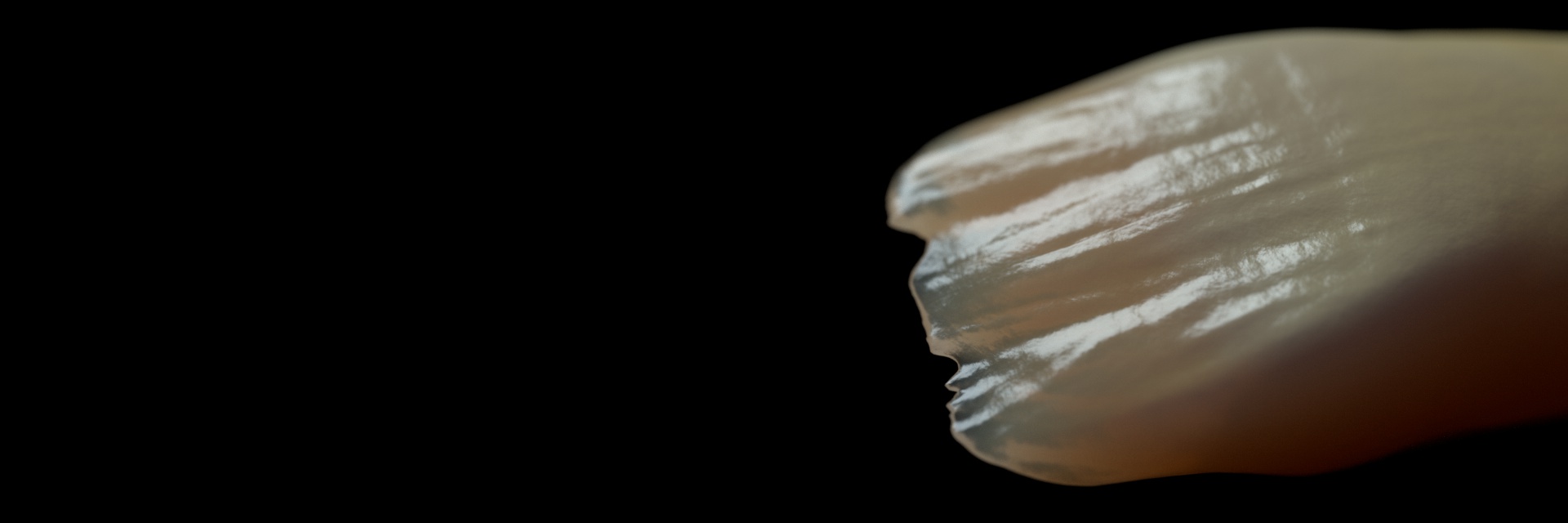

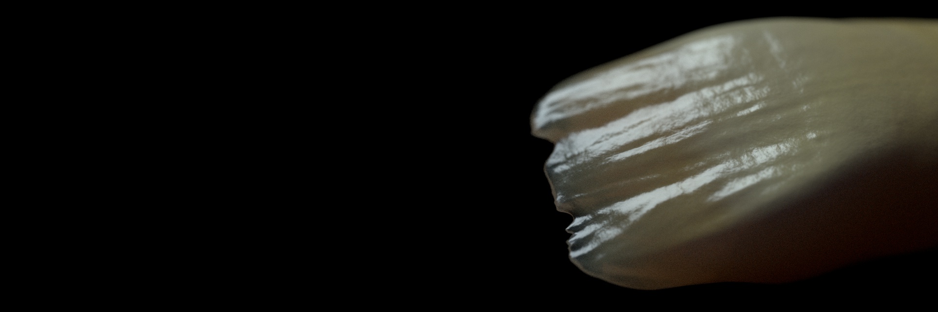

I have some strange problem when using this new release and the scattering medium. If I load the scene from V4 to the new one it renders with a complete different and much lower SSS effect. I'm not sure if this is a bug or the engine has changed somehow and previous settings are not valid?
This is how it was looking in V4

This is 2019

Any idea why this happens?
Kalua
Posts: 559
Location: Caribbean Sea
KlaNDaH wrote:I have some strange problem when using this new release and the scattering medium. If I load the scene from V4 to the new one it renders with a complete different and much lower SSS effect. I'm not sure if this is a bug or the engine has changed somehow and previous settings are not valid?
This is 2019
Try to play with the Scattering Depth. It was not present in V4.

KlaNDaH
Posts: 5
Joined: Thu Jun 03, 2010 7:14 pm
The attachment dentin-octane4.jpg is no longer available
This is 2019
The attachment dentin-octane2019.jpg is no longer available
Makes no difference, I tried even at maximum depth and does nothing
