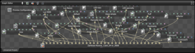

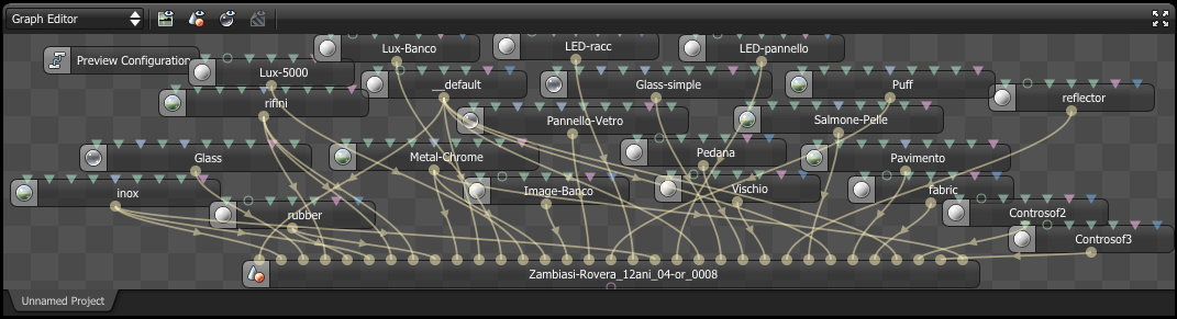

I watch your video and the problem is that you change the materials without making a material-node, look at my Graph editor, it's necessary to make a node-material for each node of the mash.

Hi, you are right when you say that it wouldn't be so complicated but at this beta stage this is the only solution, maybe next beta brings the connection from plugin as it was in the 1.22 :roll: anyway working with nodes is very pleased and powerful, please try it ;)

Anyway I encourage you to switch to 1.23 v5, it's much better than 1.22. In this case the only way that I've found for not loosing the Octane settings is to create a material node for "each" node in the mash, also the ones that are looking correct. If you don't do in this way, when you reopen a ocs file via plugin, all the materials are mess up.
