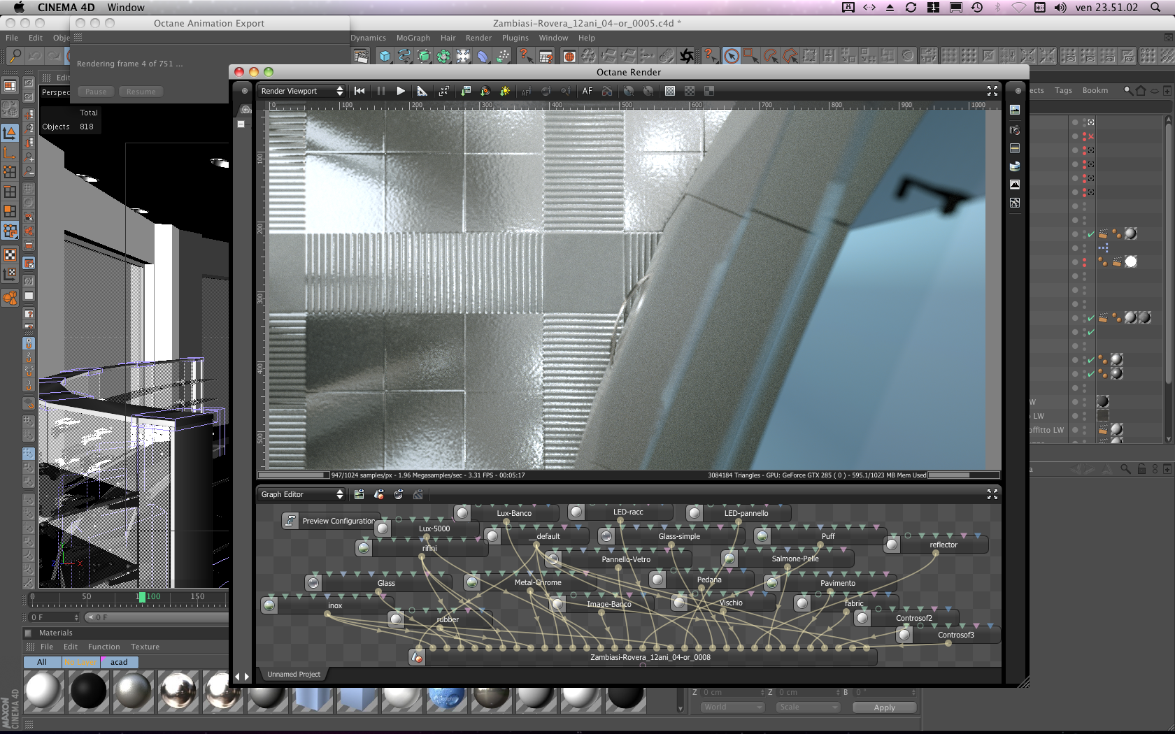

Posts: 10438
Sorry, I forgot this horrible test at 32s, I stop it immediately after I realized that it works :)
ciao beppe
