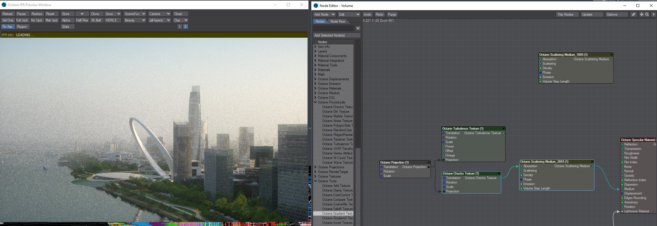

in this scene i've a big box wiht transmissive material and a medium node plugged in, and i get a nice volume fog effect.
Now i'd like to have it a density variation in volume so i plug a map in Medium but nothing happens.

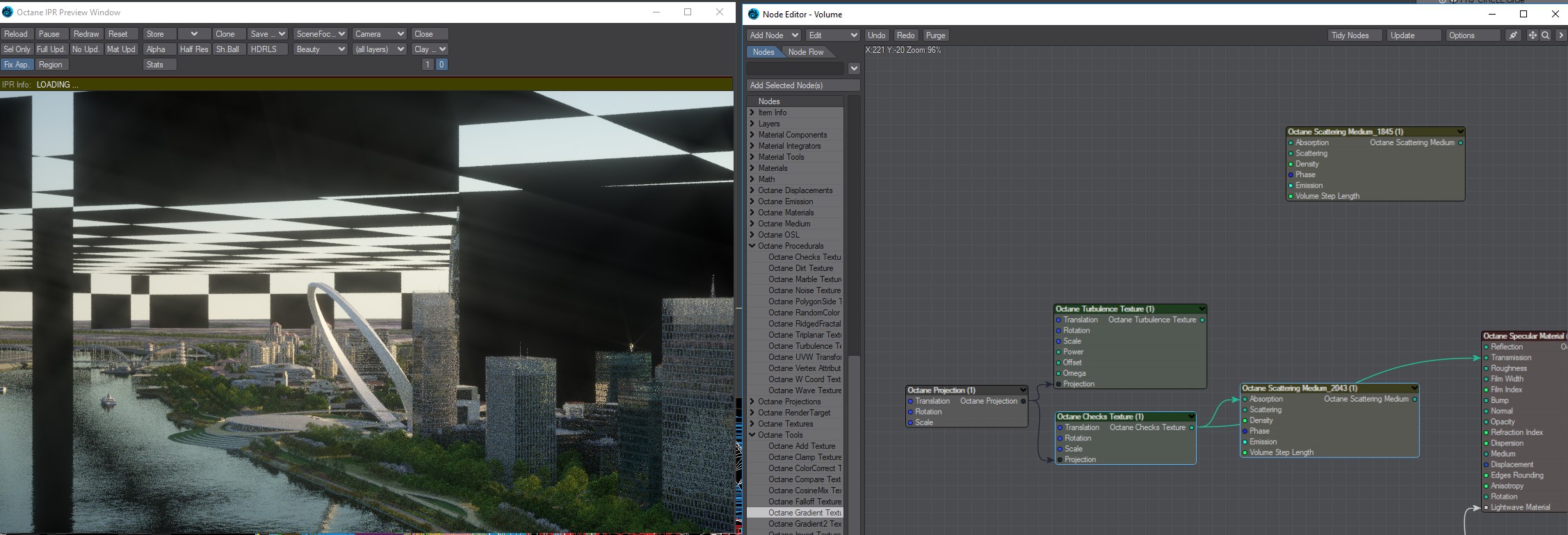

To keep it simple i tried a check texture, which is B/W so effect should be strongly noticeable. If i apply the map to Volume Box's material we see it's correctly sized and placed:

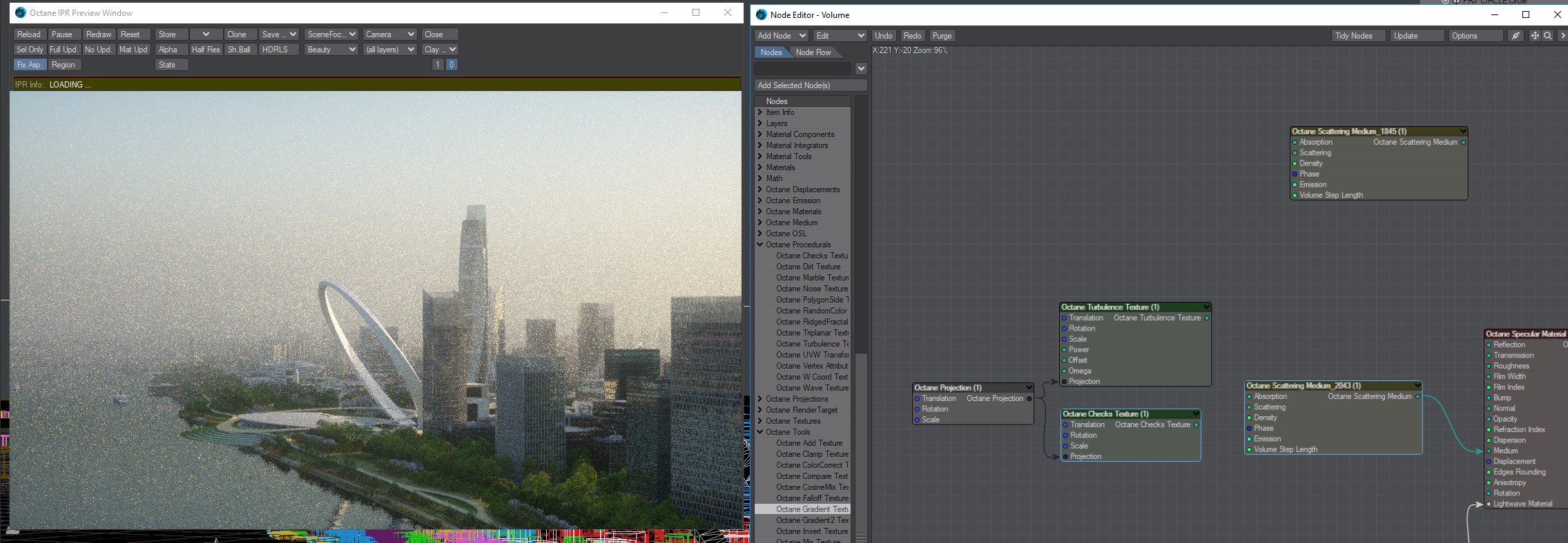

so i would expect a visible effect on volumetrics but nothing happens, no matter where i plug the node.
Is there a way to texturize density/scattering ?

Yes, unsing a 100% transmissive material and plugging a medium there will give you a "fog box" like the one you see.
Better than medium into Rendertarget since you can control it's position and distance to camera - i.e. in this case i need fog to start at a given distance from camera and you cannot get this effect with Render target Medium.
Problem is it seems you cannot set local density/scatter, if you plug any map there it sill not obey to the map.

Are you using the actual Octane volumetric object to create this textured fog? As in - adding an Octane Fog Volume object - under the Custom Objects in item properties. If you do, then a texture node is available (that takes in standard Lightwave procedural textures) for the density

Yeah, use the volume object, make sure you triangulate the polygons in modeller, and you can plug Lightwave native procedurals for your texture.
