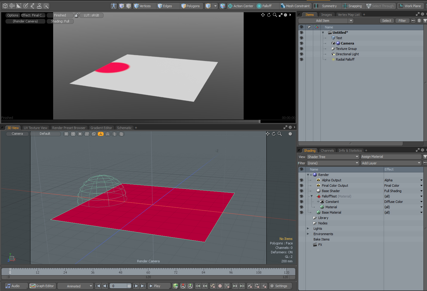

I'm new to use Octane Render for Modo and I tried to make a material using falloff to change a diffuse color for example, but it doesn't work with Octane Render.
Does anyone know how to make this kind of material?
Thanks.

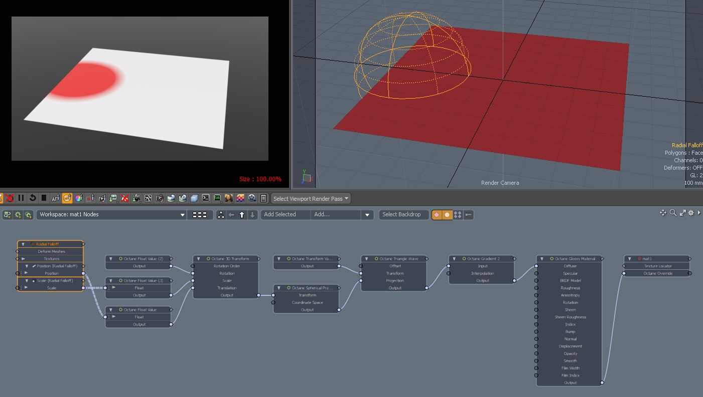

Do not use the consant shader that is not recognized by octane.
Rather use two RGBcolor and mix them with either a procedural texture of Octane, a grayscale image, or a weight map

Unfortunately it's not possible for Octane to use shader tree falloffs/texture locators in this way.
We can emulate the look with Octane nodes and some modo rigging, but it's a little complicated.
There's probably a few different ways to do it. I'm attaching a scene for you to study.

Hi, funk and francois,
thanks for the reply and funk I really thank you!!
this is so nice!!
I appreciate you guys
