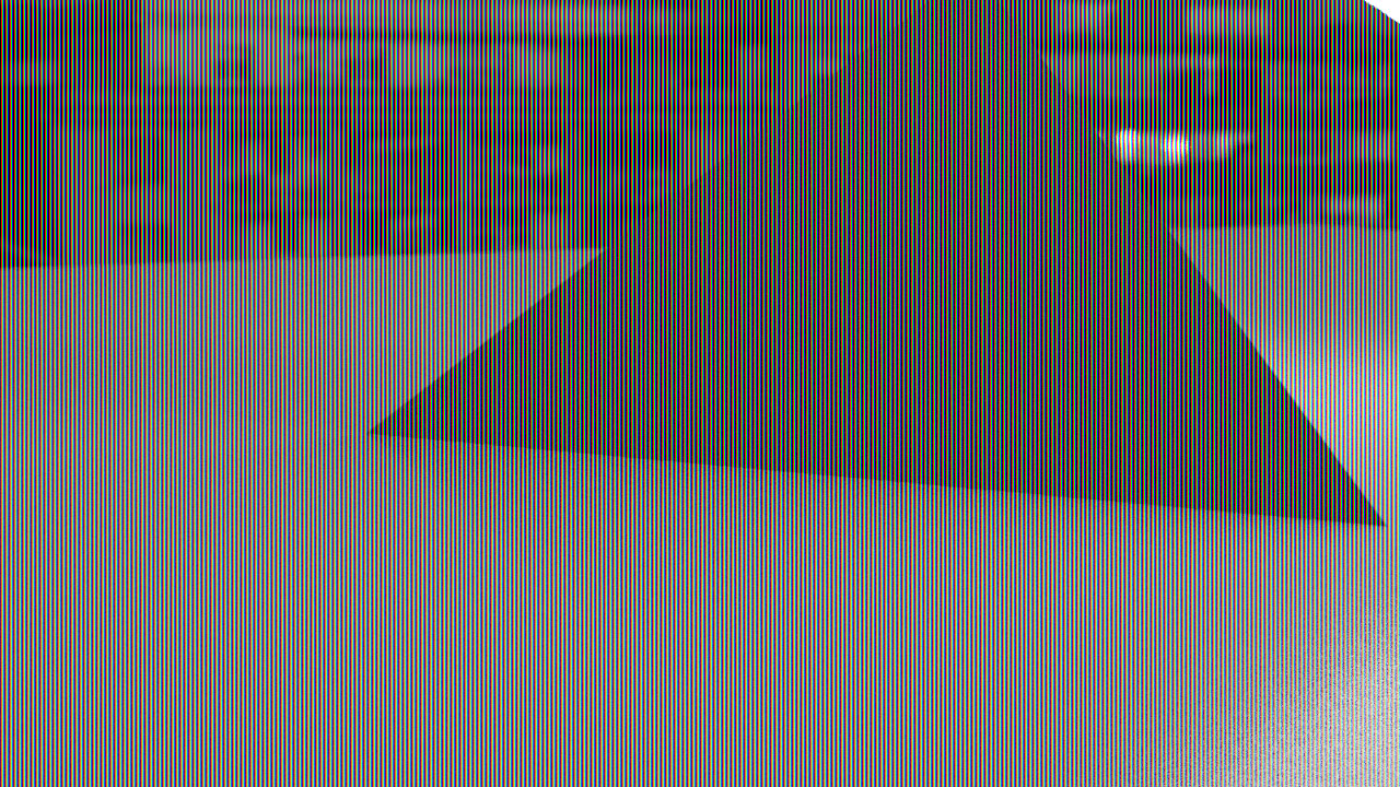

i've noticed 2 things :
rendering an exr : no crash
rendering a png : crash
i've tried rendering a simple scene : it renders
> but in the png format : the image looks buggy (vertical lines) see the jpg attached to this message.
> whereas for exr option the exr image rendered is right.
