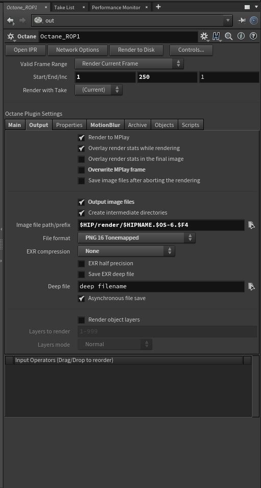

Hmm, this seems a crash in the Octane native saving functions. What are you saving options in the Octane ROP node, Output tab? Does your user have permissions to write to this folder? If you want to send me the .hip file without any additional assets or cache files I could take a look at it here.
Thanks,
-Juanjo
dotcom
Posts: 59
Joined: Mon Oct 29, 2012 7:04 am
Location: Paris, France

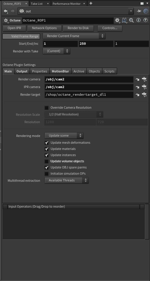

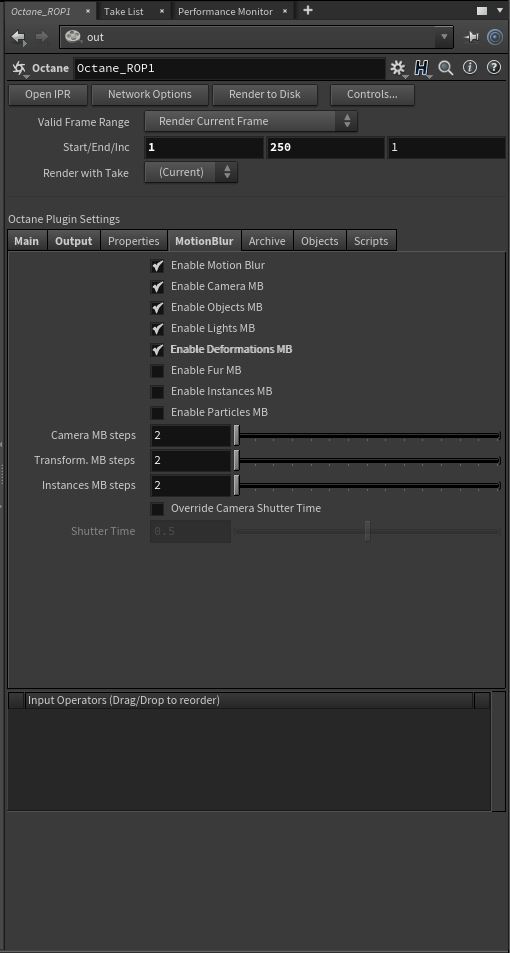

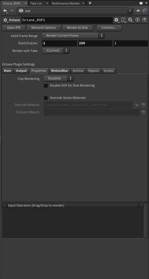

Here are screenshots of the rop output.
i've been making a copy of the render target_dl1 by alt clic and drag to have a copy of those params but the rop is fully connected to the rendertarget.
i can save files from the houdini mplay in the render folder
I've just tried to render on C: same thing happens (crash) with this last info :
5096: Fatal error: Segmentation fault.
i keep on investigating.
motion blur
motion blur
properties
properties
output
output
main
main

Tests :
adaptive sampling : render
ai lights : render
denoising : renders
MB : lets go :
i have different option to check
enable MB : render
enable MB + camera MB : render
enable MB + camera MB + objects MB : i think i i've catched the devil guy so i added an attrib delete node set to "v" to all the geo for render : render
so there is no velocity attribute for octane to render motion blur geometry at all so how will the renderer knows the pos difference between frame A and B ?
i've added this trail node just for that reason : to have Octane being aware of the computed velocity at geometry level /
Does it have to be a prim attribute or vertex ? right now it'a a point attribute.
