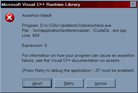

I installed the 258.96 but didn't realize til later that the 260.61 was still mounted in the system. I 'Yanked' all Nvidia controllers from my system and started from scratch with the 258.96 and all is well (with my system now). What is not covered by this was the last post where Octane crashes when I want to see the operational stats of each card (shown below - but if I chose 'Ignore' It does not exit out), and the crashes when reopening 'some' of the saved standard test models I have been using throughout the beta's, which have been working fine up to this point. Yep, just tested it now, even after correcting the NVIDIA hiccup.

Here's the error report (should look similar to the first)
