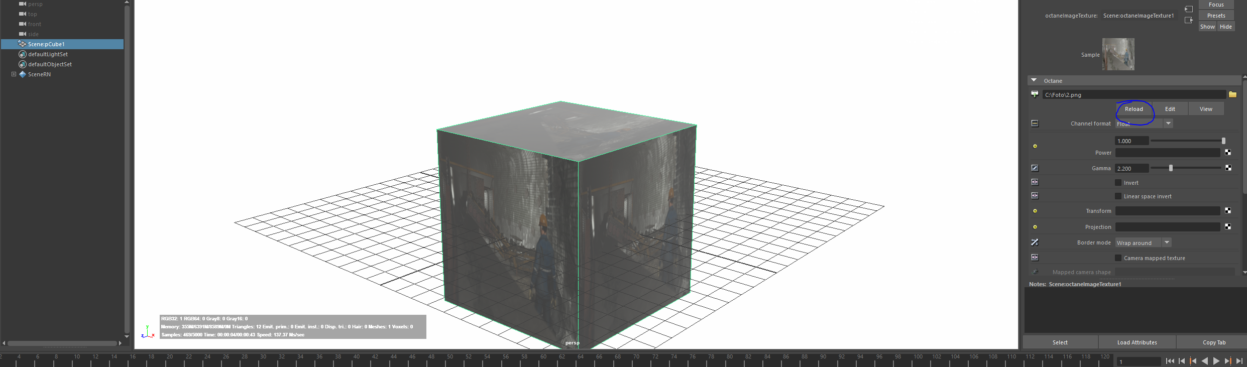

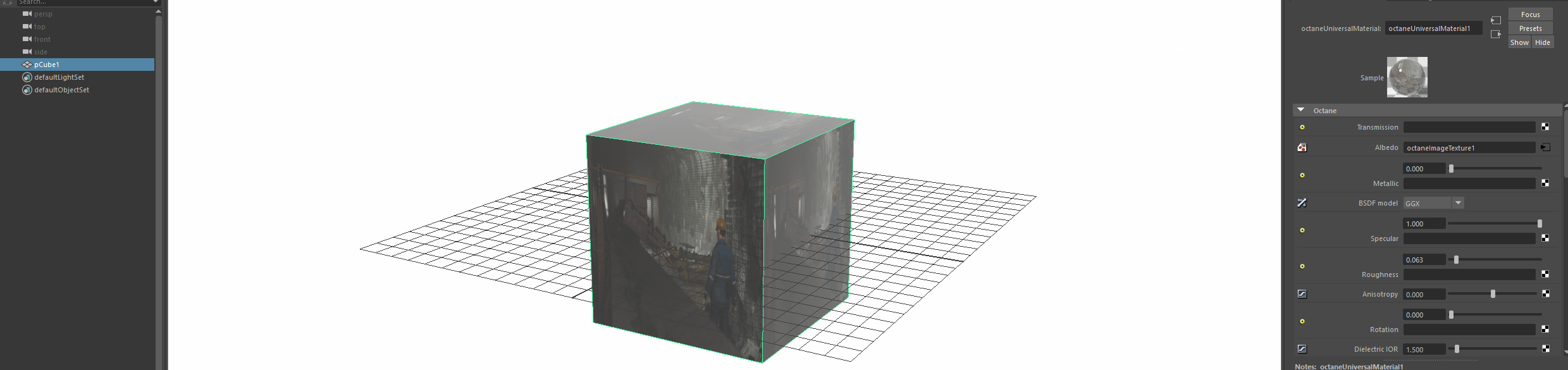

There was a problem with textures and reference system. If reference files are used in the scene, then when the scene is saved and loaded, the textures are not loaded, you have to reload textures or references.
Create Box and Texture
Open save scene
Open save scene
Click Reload
Click Reload
Locked
