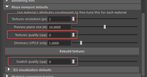

Even when no rendering is going on, with scene changes Octane generates (that means renders) on-the-fly the swatch-previews and viewport/UV textures that you observe in Maya UI even when there is no Octane render session running. Maya API is mostly single-threaded, so it is not always possible to do this in the background.
If you want to speedup the scene responsiveness - you can lower or better completely disable the generation of these textures (setting the "quality" to "0").

JimStar wrote:Even when no rendering is going on, with scene changes Octane generates (that means renders) on-the-fly the swatch-previews and viewport/UV textures that you observe in Maya UI even when there is no Octane render session running. Maya API is mostly single-threaded, so it is not always possible to do this in the background.
Hi Jim,
Thanks for replay..
But was thinking...my Hypershade is set "OFF" why would calculate ? okay I will give a go.
Best,
JO
Hi Jim,
Yes is much better and faster! with t his settings faster for export aswell thanks a lot! we are using on our workflow to make fast !:)

Postby JimStar » Wed Feb 13, 2019 7:40 pm
JimStar Wed Feb 13, 2019 7:40 pm
Jolbertoquini
I've just had a talk with engine team regarding the highly inefficient material-preview generation functionality. They've confirmed that it's the functional part of the rendering engine that has not been improved yet (following all the other rendering-engine improvements in recent versions), but it definitely has some room to make it faster.
So, perhaps with some later versions of Octane engine you'll not have a need to disable the preview generation or at least just make it some lower quality...
This doesn't seem to always wok, not for sunsky node for example, any animated attribute in environment slow down Maya a lot whatever preview settings, this is quite unexpected as environment are not displayed in Maya viewport or UI...
Also Jo have a good point about swatch preview : why is it needed to disable swatch-preview on the octane side, when swatch preview are already disabled on the Maya side ?
If they are not even displayed/refreshed in Maya UI (disabled in attribute editor and node editor/hypershade) they should not be generated automatically in background slowing down Maya,
but only generated on demand (when clicking in the swatch preview square).

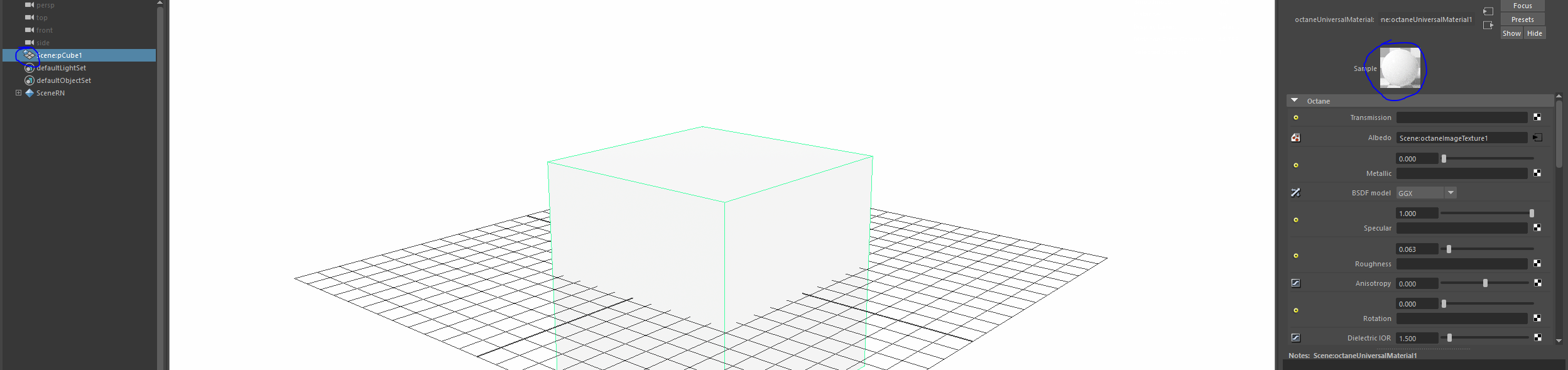

Hello
Sorry for bad english.
There was a problem with textures and reference system. If reference files are used in the scene, then when the scene is saved and loaded, the textures are not loaded, you have to reload textures or references.
Create Box and Texture
Open save scene
Click Reload
