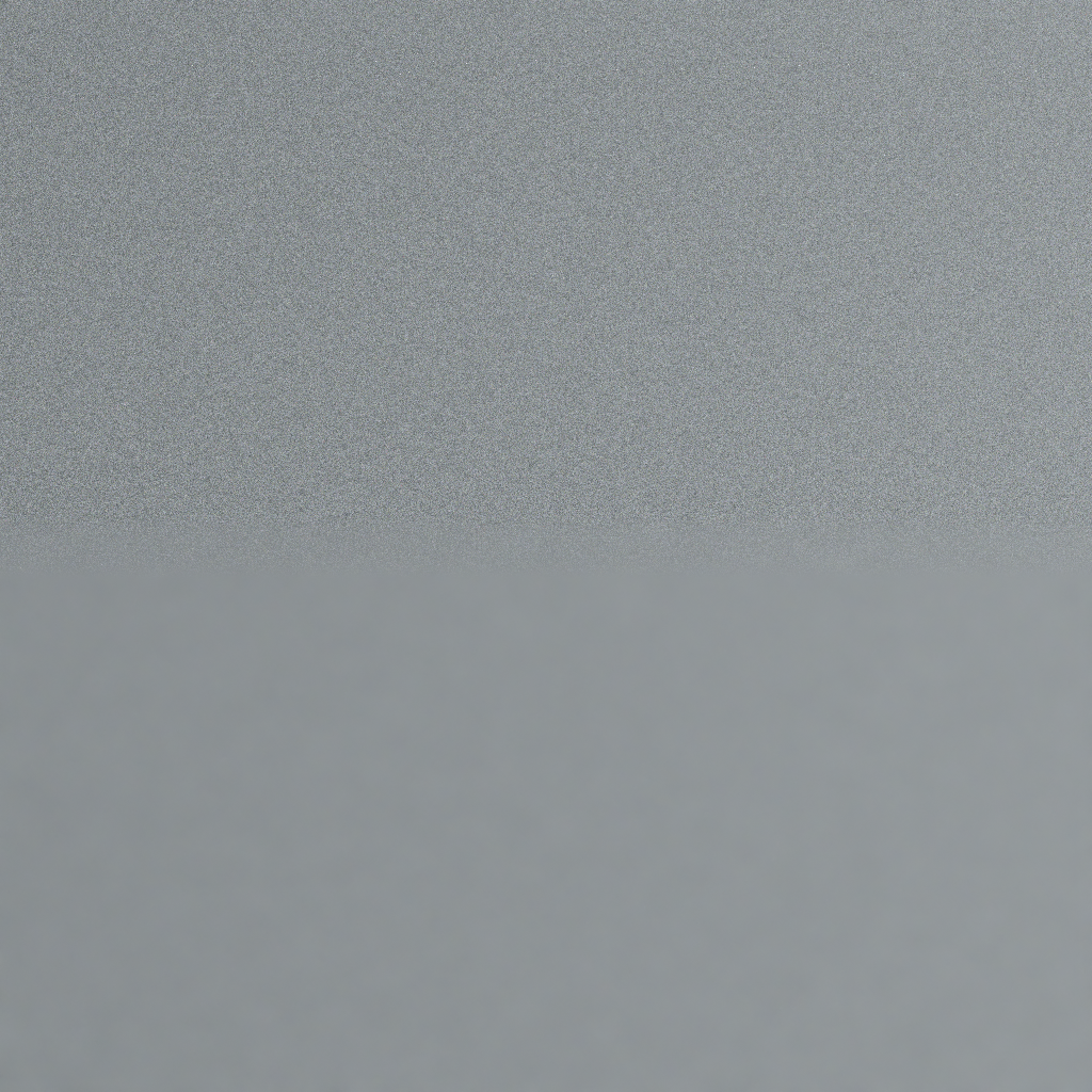

In the final v4 version, I only get half of the image denoised. It has a blurry border so it's mixing 2 halfs and one is not denoised.
In the octane render the issue is fixed if I move the camera. (only happens when I render the loaded scene)
I also have the blender plugin and there I didn't find a way to see the complete denoised image.
also, you can see that the half is the closest to square so one is divided horizontally and the other vertically
another baked image to better see the effect:
Win 10 2080ti driver416.81 32GB Octane 4.00
v4 half image denoising

Thank you for your explanation. I admit at first I needed some time to find the setting but obviously I did otherwise there woudn't have been any denoised part of the image.
The images uploaded are from the denoised beauty tab in the standalone renderengine and from the beauty pass in blender.
I also tried the blend parameter and it works as predicted as in it mixes the noisy image with the half denoised one.
It's also interesting to underline that it only happens in the first render in the standalone but in blender, since it restarts at every frame it's always half-denoised even in an animation.
