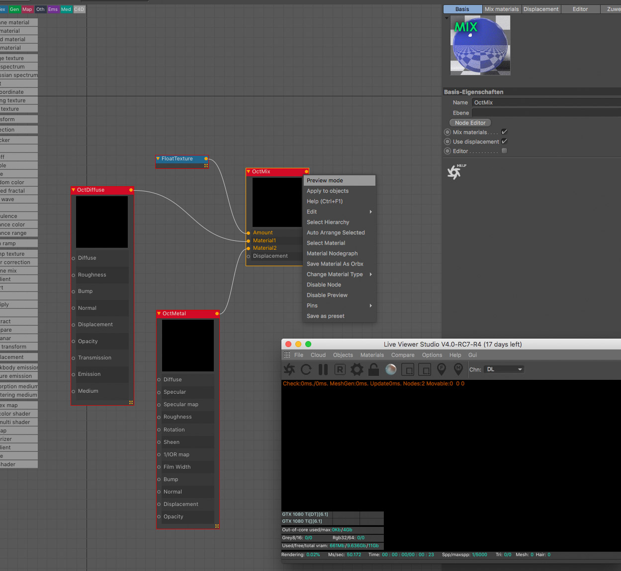

stupid question but how to convert a mix to blend mat?
Thanks.
Posts: 16068
Location: Türkiye
y81r wrote:stupid question but how to convert a mix to blend mat?
Thanks.
Select top mix material and apply convert materials" command.
