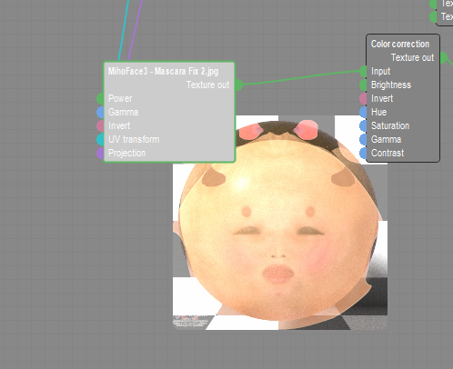

rajib
Posts: 401
Joined: Sun Sep 28, 2014 4:57 am
Hi Paul,
In the NGE, the preview images seem to be mixed up. See attached file. Looks like it rendered the face over the torso buffer. Hence the double image. All the previews are wrong for me. This is with the latest 4.0.0.40 verions
Preview Image mixed up
This is the direct preview of the JPEG file.
I was unable to replicate this issue.
